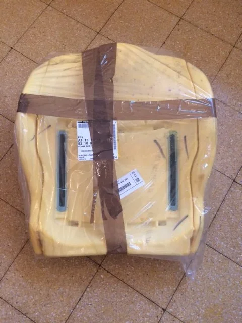

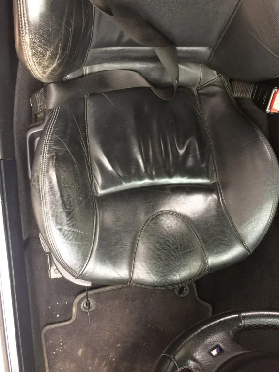

I have trouble with the drivers seat, it has gone flat on the right hand side due to access, I can feel the frame when getting out.
I am getting a new foam for it [from BMW dealer] and ideas on fitting it will be appreciated.

I did get a couple of prices and they were talking over £200 including the VAT , the seat foam is costing £126 [inc VAT and delivery ] from Cotswold BMW s, but I feel happier going this way.

Intending to replace with a new piece from BMW. I intend keeping this car,(my son originally bought it 6 years ago next month.)
Passengers side is still perfect.

You don't really need a new seat pad. The hard work is taking the cover off and putting it back on again - the hog rings are difficult to manipulate.
It's pretty simple to get some upholstery grade foam, spray glue, cut the split area out and replace it with a piece of the repair foam. And for good measure you can top it with some 3mm scrim foam.
The leather is usually affected enough it needs to be properly restored with colour and sealant.

The leather on the seat base is OK at present , but the back will be getting a bit of tlc when [should say if] the weather ever improves.

Job done
Feels a lot better now , really comfortable again.
Clean area under seat , even found a few pounds down their.
