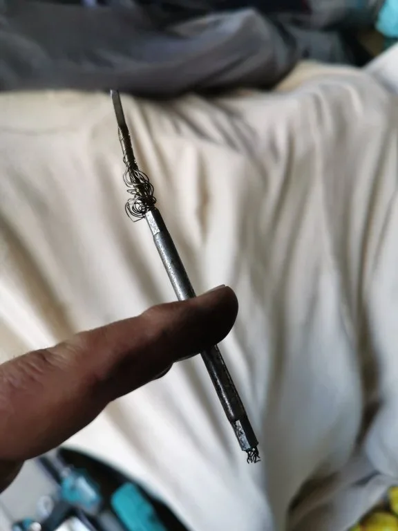

Like it will give that a go - from you experience is there a high probability I could damage the spindle sufficient so I wouldn't be able to replace it? Irrespective I guess I could always source some replacement spindles via a breaker.
If you put too much torque through the spindle it will likely buckle, so take it easy paying attention to the direction of winding.
As for getting hold of spindles, you’d need to find a breaker who is stripping the seats apart. That only tends to happen to really whipped sets, as selling the spindles makes the seat unusable.

Job done but at the expense of one of my spindles - now need to source another one so hopefully someone is breaking a seat.

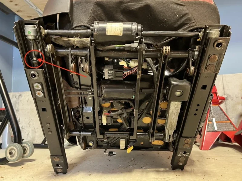

Yeah I believe you. They key was to use the milquakee SQ1 square bit (similar concept to what what 2bmws mentioned above), and connecting it directly to the second (further) spindle which sits in the rail itself since trying to move the seat by attaching the drill with the attachment to the silver differential (I don't know if it's called a differential actually but it's the silver looking thing with a green dot in the photo that transfers the torque from the electric motor to the rail) only resulted in the second spindle (the one coming OUT of the differential) buckling because the rail was stuck.
Anyway, I recall removing the second spindle and attaching the square bit directly in its place (which required a long extension too because I have to approach it at slight angle) - this way I could transfer way more torque to the rail vs doing it through the differential and the spindle. Believe it or not, it still took hours of messing with it (with loads of WD40 all across the rail) before it finally gave up and moved.

Dude you are a saint for posting such an in depth reply so thank you. Did you have to pop that little "differential" out? If so, how did you do it? I can't seem to get anything in there to pry it out.
No, I didn't remove it. I was able to approach the square hole (circled in the image) with the square bit 'head on' using a long extension, angling slightly upward because, as I am sure you're finding out, it's hard to 'connect' your drill to that hole directly because the differential is in the way. With a longer extension, there is 'play' in the linkage which allowed for enough angle to insert the square bit.
I also remember that it wasn't easy to remove that spindle going from the differential and into the rail. I think I had to pry it out (thankfully, it has some 'give', essentially being a very tight coil). You might want to be really careful there if you're trying to save the spindles (I wasn't because I had a new set of seats ready to go). Still, I am pretty sure I was able to 'save' those spindles when taking them out.
Oh, I also remember hitting s*** with a rubber hammer. A lot.
Denis you are a gentleman and a scholar, thank you man. I managed to get the spindle out, just need the proper bits now, I'll update when I have a chance to get back to this. Thanks for the assistance, I was about ready to get a sawzall and start hacking at it!
