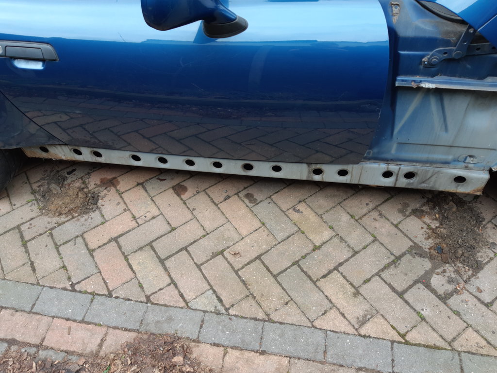

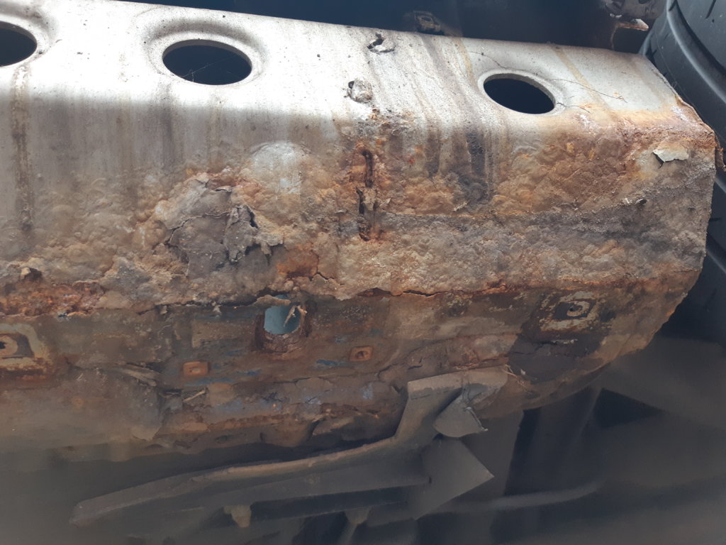

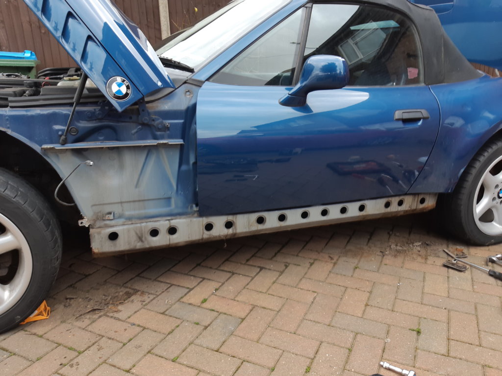

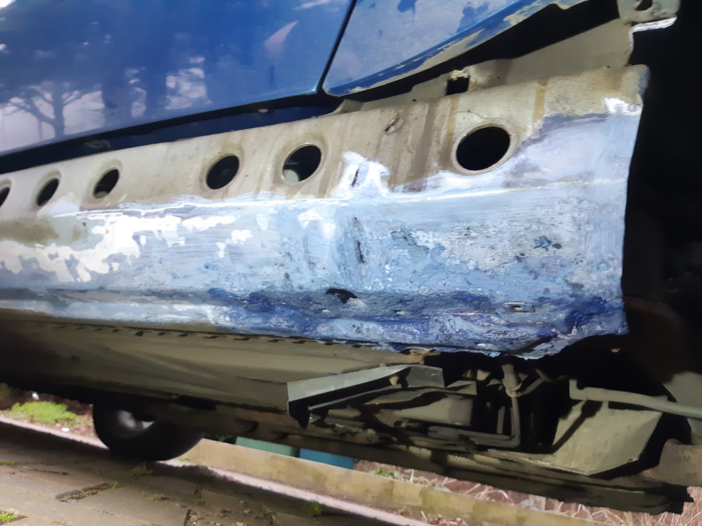

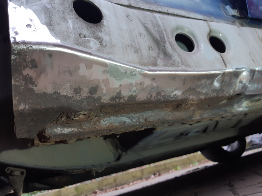

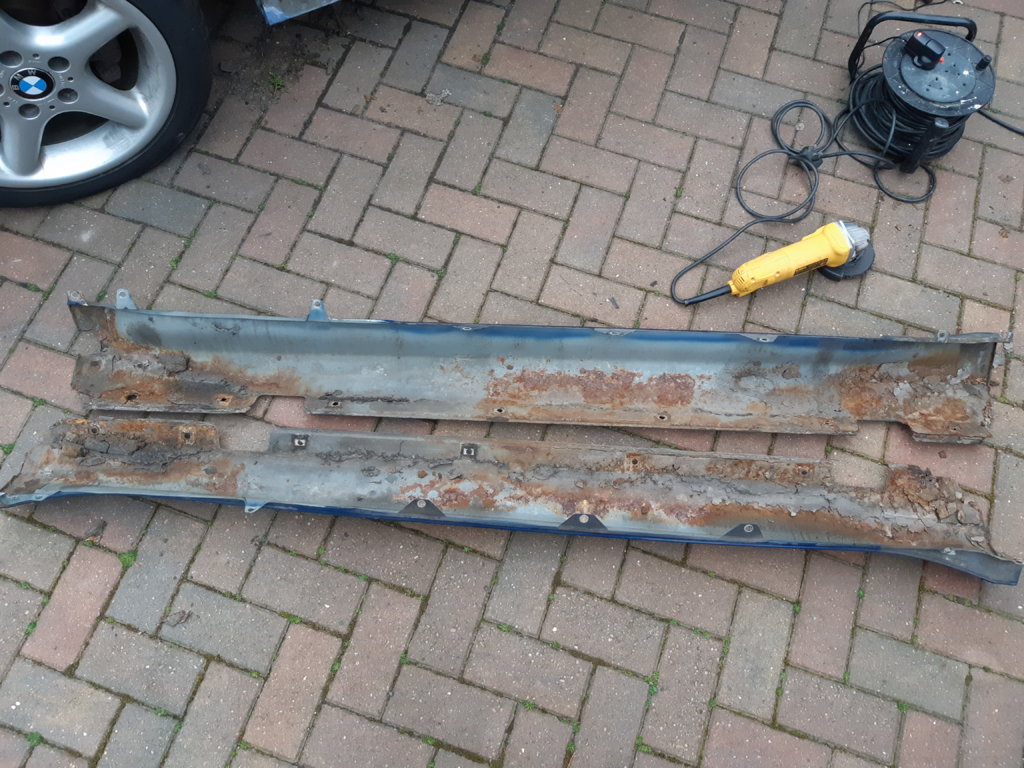

Started the sill replacement today, removed the old ones (what didn't fall off that is) with the much appreciated expert help of @Mnbrennan
I was pleasantly surprised to find the inners weren't as horrific as I was expecting. Not the lovely amount of dirt and crud by each tyre!

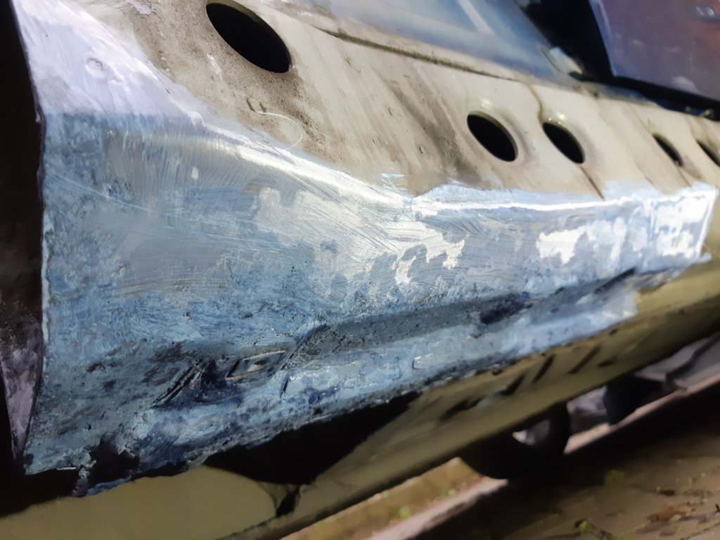

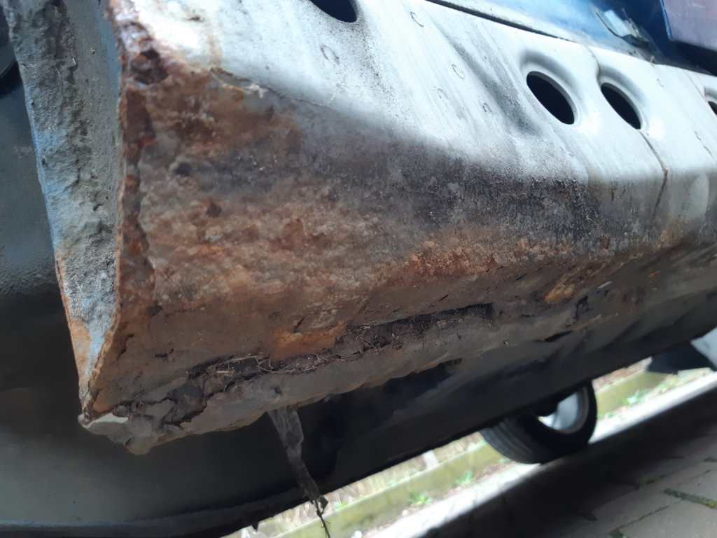

Bought some prep wheels for the grinder and got to work de crusting the near-side. Got the worst off and was quite impressed with my first effort of cleaning up

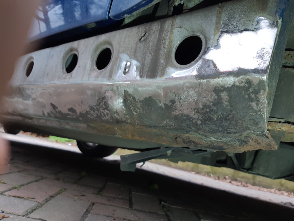

After another quick once over with the grinder to catch bits I missed, I painted the cleaned parts with Vactan to treat and cure the rust and exposed steel.
Tomorrow if the weather god's are kind I will clean and vactan the off-side sill, treat both with dynax s50 on the insides, and then spray the outsides with primer

I hate to tell you but those inner sills whilst generally looking reasonable have some clear signs of rot on the end. They look like they need welding to me.

Hopefully it's a trick of the light. Perhaps you could post some more photos closer up? Did you see any perforation? Sorry if I'm raising a false alarm...

yep have to agree with the above they dont look too good... i had my sills off my 2.8 and they not as bad as that...
i think you may need to get some patches welded on there...
sorry to be the bearer of bad news...

The outer edge was starting to go a bit flakey, but I managed to get it back to the good shiney stuff I think

I agree. I've very recently - 31 Jan - had my car go through, what I can best describe as a CAR SOS - and had its front wings, sills and rear quarters replaced, both sides and then the whole of the car prepped inner and outside, treated and painted. Yes, a big job but the car is wonderful and I love it (a 20 years love affair from new). I've been in and out of the bodywork place - guy whose business it is worked on Margaret Thacher's armoured car and the same for members of the Royal Family cars - he's an expert - and he was relieved that my car was solid once he removed the bolt-on parts I've described. I mean, there was no rust on the car's actual body.

Great work there. Hope you’re able to get to all the rust and remove it without the need for welding.
View attachment 97809 View attachment 97810 View attachment 97811 View attachment 97812
View attachment 97813 View attachment 97814
View attachment 97815 View attachment 97816

Having seen these first hand the inner sills are not perforated. I think mine were in worse condition when I started the job a couple of years ago and I believe they've turned out OK
The difficulty of course is in stopping the rot from continuing. I'm considering buying a set of inner sills from BMW to swap over when the time comes

There are still some area's that have very heavy rust build up, I have to aree with Robert @mrscalex that they are area's of concern, If you take a panel hammer to them you can knock most of the build up off, this will give you a better picture of whats really going on

Its not the worst job in the world but does require a skilled person to do the job, after all they are the back bone of the car, the heavy guage steel makes it a bit more difficult to remove the old sills, seats and carpets need to come out, other areas to consider are the end caps and the sub frame mounting areas

@ktnez99 I've got new outer sills, there is nothing left of each end of the ones I removed! We met at c&m and talked about your full body repair.

Excellent news the inners are still ok mate. Gotta say, when I first saw the photos I also feared the worst like others did. Was probably just how the shadows were caught in some photos
