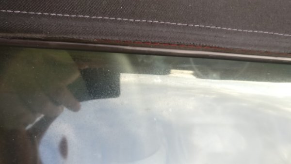

Rear window zip exposed
PSD
Apr 19, 2017
50
Tickhill, Doncaster
1999 MK1 Z3 1.9
Hi guys,
I just noticed that the material around the top of my rear window is coming away and I can see the zip. Anybody have any tips as to the product to use (I assume glue?) to fix it.
Picture attached.
Thanks in advance.

Double sided tape is used to hold that flap down. Don't be temped to glue it as you'll have a hard time removing the glue when you come to replace the window sometime down the track.
