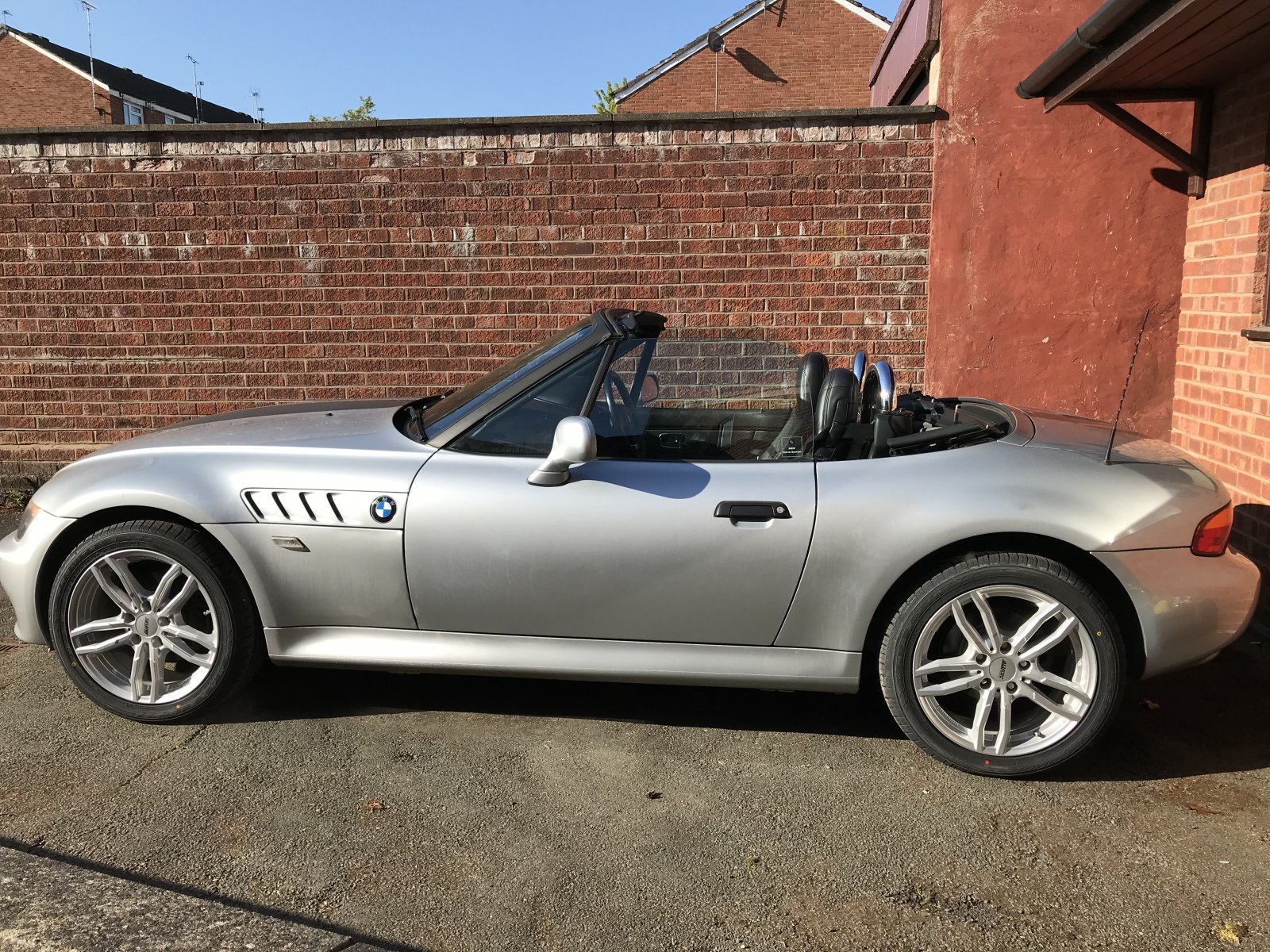

I've got this set up on mine at the minute, and have no problems. The wider tyres at the back fill the arches a lot better than the standard 7.5.
This isn't the best angle, but it's the only one I've got at the minute on the phone. I can get some better photos tomorrow if you need some. I think the rear tyres are actually 245/40/17, this brings the rolling diameter to the closest of the original 225/45/17. Hope this helps.

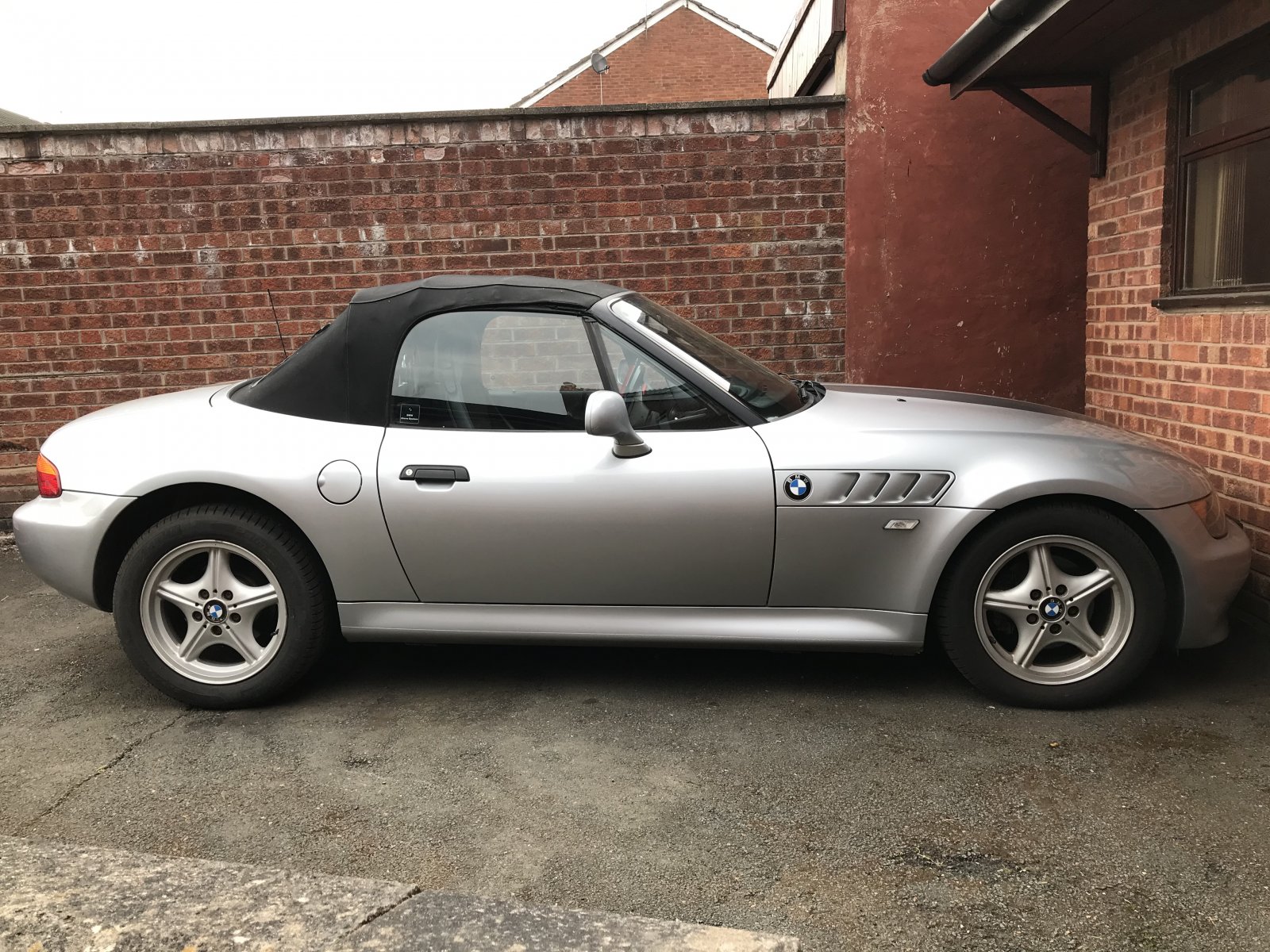

Style 68 should fit nicely on a pre face-lift model
I have them on my face-lift and they could do with 10mm spacers to bring them out a bit so would fit nicer under the narrower rear arches.

Looks great (they both do by the way). But I get what you mean. The OEM rims can get expensive quickly with extra spacers, bolts and some refurbishing!
Can you feel the difference between a 16 and a 17 inch setup (stiffer sidewalls)?
Hi Rob,
The ride is only very slightly stiffer and really not that noticeable! I'm still amazed that such an old car has absolutely NO rattles over the bumps!
Stevo's post above shows the Style 68's that i had decided on, before going down the new wheels route, and i still think they look great!
