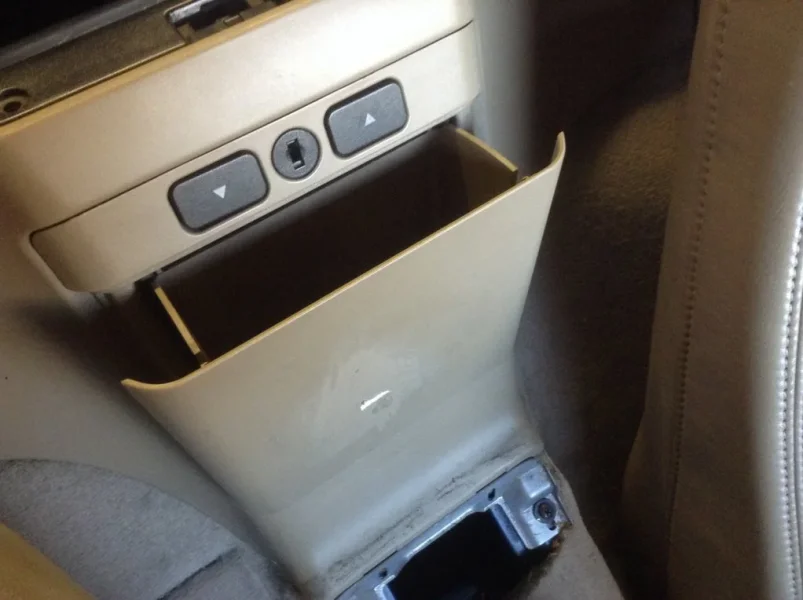

    I'm attempting to replace the small rear storage bin, can anyone advise how this comes out??
    The new one has arrived complete with a pin to go through the hinges but I cannot for the love of money find an easy way of getting it out.
    As ever nothing is easy on these things.

    4 screws at the top and 2 towards the bottom to remove I think. May be difficult without removing the rear console from the car first

    The only way to remove it is to remove the entire center storage box.....There is no other way unfortunately.

    Thanks for the response, I thought as much. I've tried to remove the main centre storage box but that also seems a tough job as the roll hoops / trims seem to be in the way. Do the roll hoops have to be removed??

    Roll hoops, both seat belt turret trims, and center box need to come out. Bit of a mission, but at least you get a chance to give the interior a good cleaning... BTW...you will find it heaps easier to work in the area with at least one seat removed...Just make sure you disconnect the battery before you disconnect any seat power connections...and don't re-connect it until the seat is first connected.

    Thanks for the update, I already have the main centre console out as I'm working on another issue. The seats were planned to come out for the next project anyway so I will remove the rear console out then. I have purchased a new small bin so this job has to be done.
