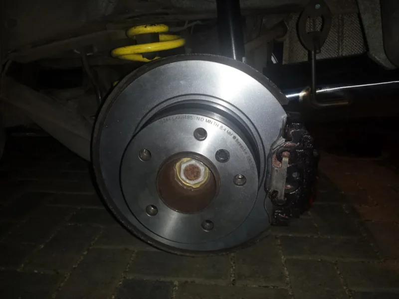

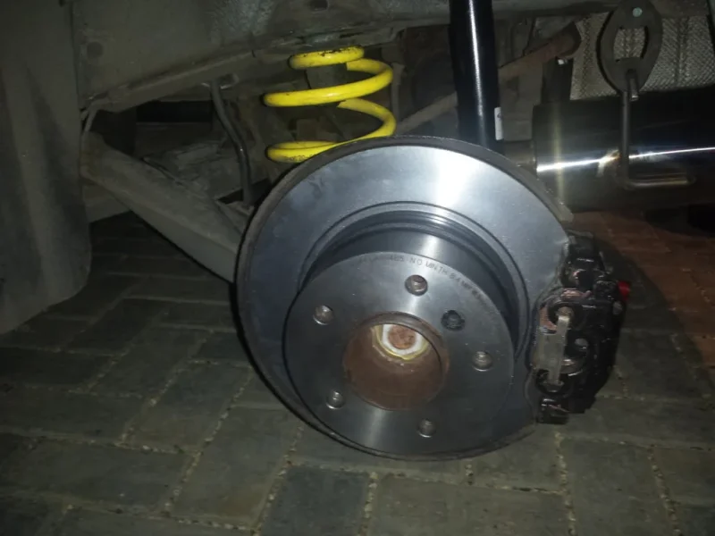

Had an unusually click/knock in the rear brakes it only appeared on harsh braking and as said only on the drivers side.
Stripped and replaced the discs and pads went with Brembo in the end as only £10-15 difference from the budget version.

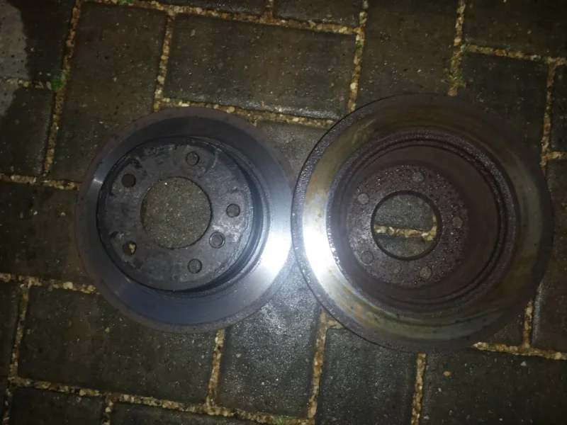

The brake discs have always been ready as can be seen here.
Rusty on both faces .The Brembo's came finished on all none contact surfaces which was nice means i don't have to paint and no surfaces to rust !
Back plates where all perfect nice as a lot seem to rust no signs of leaks and no noise at all on braking so job well done :thumbsup:

Good Job, keep an eye on the wear pattern on your new discs for the next few miles, the old discs show you were not getting the full use of the pads at the outer edge.

The pads where un even worn but the discs where rusty to the edges when i got the car.
Will keep an eye on them but replaced the pads too there was lots of meat on them but as i was doing the disks the pads where a no brainer:thumbsup:
