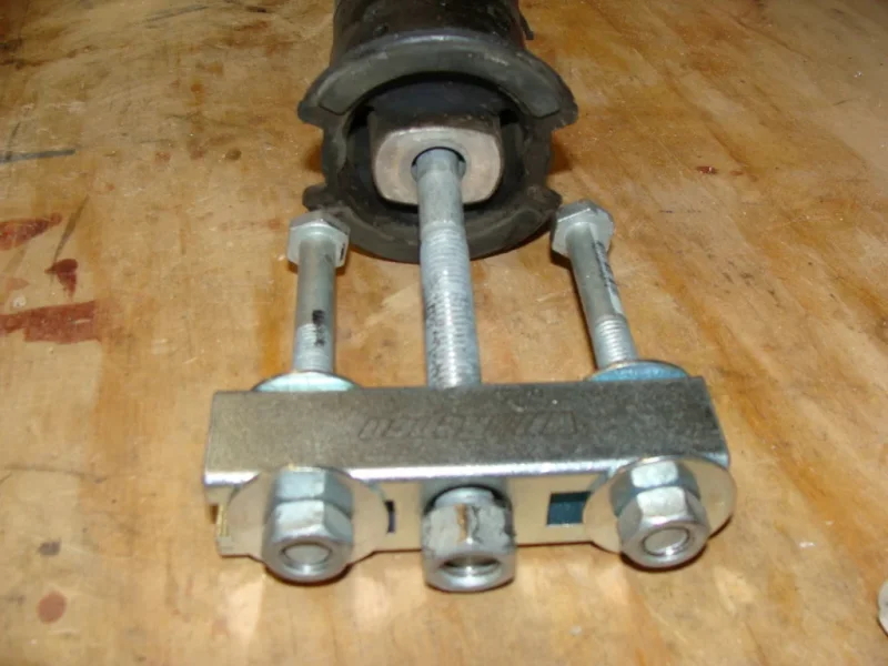

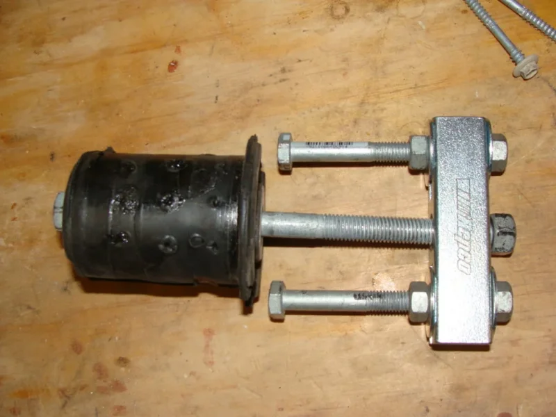

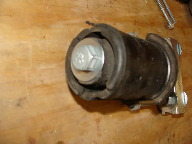

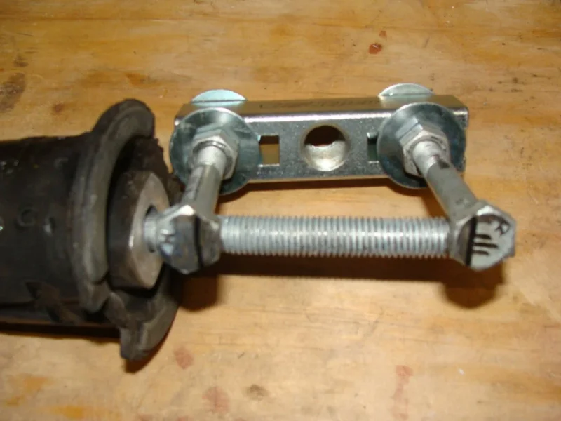

Photos below of a cheap alternative that works. Beam is off a steering wheel puller kit.
Cheers, this looks good! Something I could put together with bits I have!
