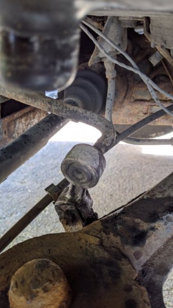

One of the MOT failures was the the fact that the ARB has popped out of the drop link bushing. IMG_20200528_154829.jpg

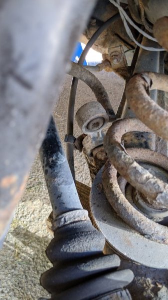

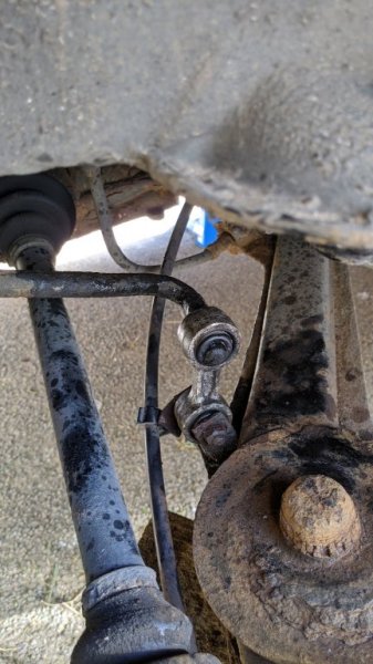

I'm changing the rear springs at the moment and I know a drop link change would be the better option, but for now, how do I get it in? IMG_20200528_160654.jpg
The 13mm bolt looks pretty rounded so I don't think that'll come off any time soon
spurs fan in a coupe
3rd Party Trader
175
Easy to swap out with a bit of fairy liquid on the top join, the lower bolt with 13mm either end will come with a decent branded new link.
