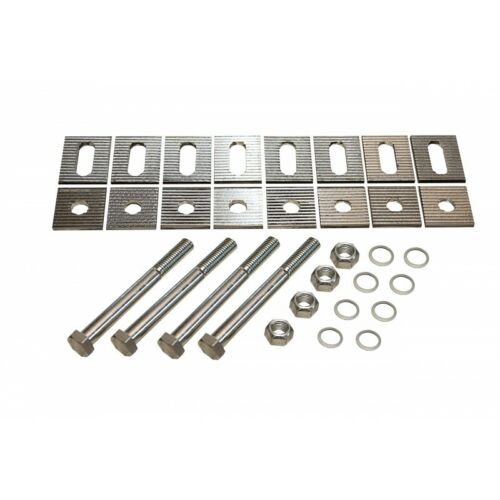

Has anyone used these before?
Trailing Arm Camber/Toe Adjustment Kit for BMW E30, Z3, 318ti (bimmerworld.com)
A few guys have on here, bare in mind you’ll need to drop the subframe aswell to weld these on. Plastic fuel tank is mm above.

I have heard of them coming loose and going out of adjustment but this maybe just a rumor as I have not actually spoken to anyone who has had it happen. They will be a big improvement but you do need to remove the rear subframe to weld everything in place.
I went with the toothed weld in ones. They are not as easily adjusted but they lock in place when a standard bolt is tightened. Mine were installed so I could correct the excessive camber from the car being lowered.
I have similar i'm in the middle of fitting to 2 rear beams, a company called, I think, born2drift uk. A quick google or ebay should show them. £60 a set if I remember.

I used some of these on mine
but mine was more to get rid of the excess camber ( it may be lowered a tad). If you've got a problem with just one side then you may have a bent arm, probably from some previous owner exceeding their talent quota for the day and visiting the kerb a little too closely. And ferociously.
