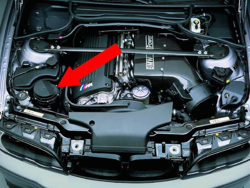

Hi Bubbling/Rattling thats two very different sounds, can you decide either way or be more specific? Also is just on start up or does it persist? Also do you have the anti smog pump fitted? (front left side of the engine bay, black and round thing

I was wondering if it was the emissions pump? Mine used to make some really strange noises for a few mins on start up

Rattling could be the Vanos i suppose but the airpump if defunked would make noise at start up like suggested:thumbsup:
Mine did too but it ran continuous for about 30 seconds.

I am sure the air pump thing can be deleted? I am sure I removed it on my first 2.8 but I might be wrong

Yes Tony, it can be and really there is no good reason to keep it on a car here in the UK. I ditched mine because the bearings in the motor were shot and it howled it's nuts off till the relay switched it off.

Can you refresh my memory of what to do to remove it.. I thought I had removed the last one as it was no use here in the UK
thanks
Tony
Yes mate, you can unplug the wiring to the motor and tape it back and remove the small vacuum pipe from the unit fixed to the head and plug it with something (I pushed a ball bearing into mine). Then take the unit off the head (I have a few blanking plates left) and cover the port on the head. The main pump is fastened down with 2 13mm nuts.
