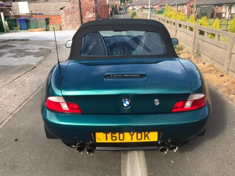

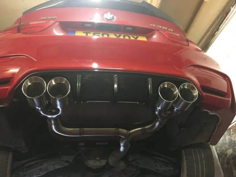

I got mine from stg performance Wakefield Shane did both mine z3 and 4series

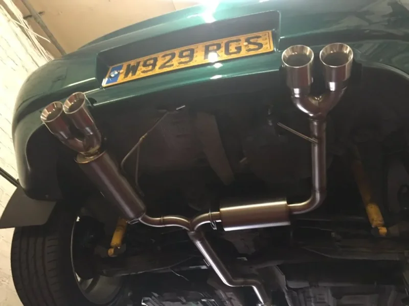

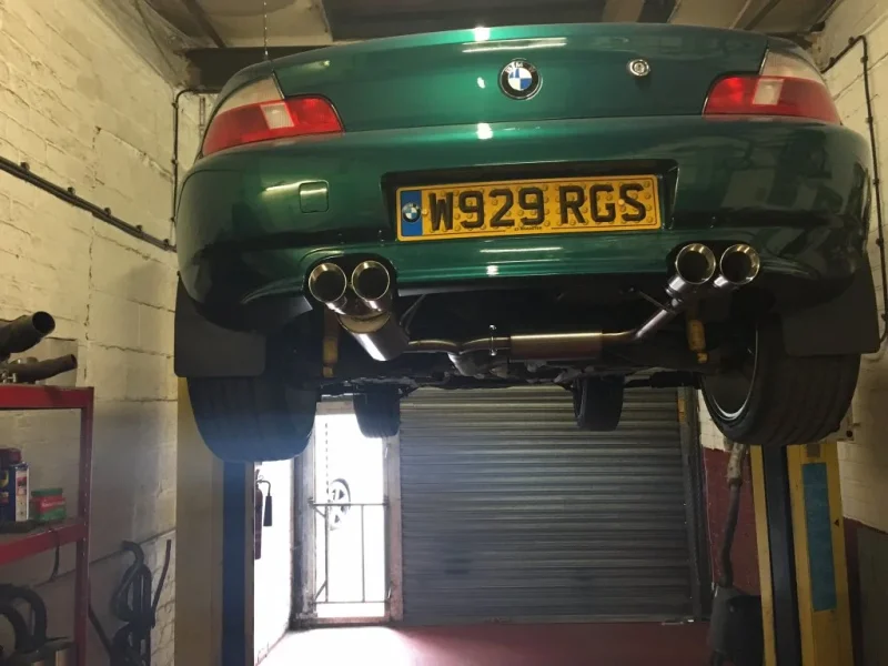

This is mine, a similar layout to the eisenmann version.
Cost me £350 to have made up this was 5 years ago at a garage in Brierly Hill.
If I had it done again I would have the 2 silencer version like Yocky's as it can be a bit loud at about 2.5k revs.
Photo's not the best as I had to zoom in and crop.
also it is 5 years old now

Looks very good, good underside pics, I don't think hers has the separate black trim panel around the exhaust, one of those with no cut outs would be handy, are they available anywhere? She wants a bit loud !! I think she has regressed a bit now she has reached 3 score !

it is not a separate panel, it is the original bumper but with the bottom painted satin black. I cut out the bumper symmetrically opposite to the other cut out, using a cardboard template, then went to the exhaust place.
I like loud too, and it sounds great, it just is a bit loud at those revs coinciding with about 50mph which is where I usually am on A roads and then can get a bit tiresome,. but accelerating makes you grin... and the pops when you ease off, are great.
If I want it quieter I usually change into a lower gear.
also he cut the exhaust and put two flanges on for easy removal doing jobs

Shane at stg would custom make the exhaust to fit the z4 only charged me £400 for the z3 knows what he is doing always a waiting list.
