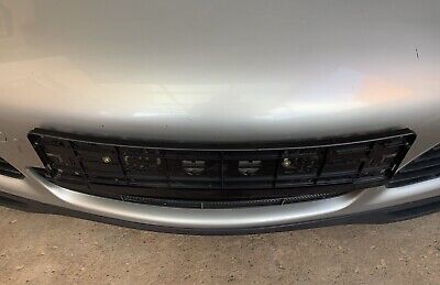

The E85 has a curved front bumper, I've noticed there is a nice fitted number plate holder which allows you to clip a plate in.
The E89 is also curved and doesn't seem to have that option, number plates either screwed or taped on directly.
My existing front number plate had the backing material start to debond, black mould to start to form. It did go through MOT but thought it best not to risk an advisory next year.
Bought new plates, found a number plate holder on Amazon. Screw the back plate on the bumper, clip the new plate in to the holder, swing the holder down and engage the bottom clips.
Except it doesn't really work - the bottom clips pop out because of the curvature of the bumper.
Put a grubber screw in the bottom middle to make sure I don't loose the plate. The two sides still pop out, so another grub screw on each side to hold it down.
But looking at the back of the holder on the sides, it's an awfully thin piece of plastic that seems to be holding it on and it looks stressed. First Yorkshire winter I suspect thats going to go brittle and separate.
What I really need is an E85 number plate holder for the curvature of the E89 bumper.
Anyone have a solution ?

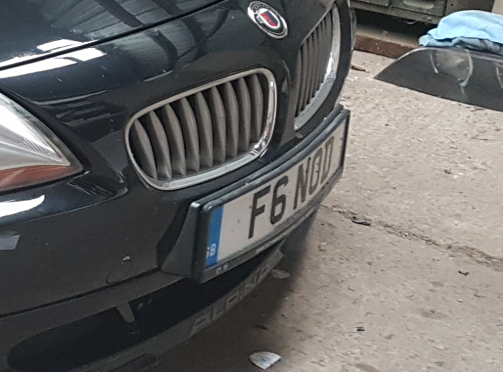

Hi Alex, did the plate holder work out?
AleNod
Dec 19, 2018
114
Huddersfield, West Yorkshire
Z4 E89 20i sdrive roadster
@AleNod
@Nodzed it looks like it should, its stamped Wurth and looks pukkah. Have to squeeze with your thumbs on each side of the bottom piece to unclip and then slide the plate up and in. But I need to check, I think you may only be able to slide in once as there looks like a danger some holding clips may break off. I need to fiddle . . .
Should have fitted Saturday but too hot (think I had a nap and a beer instead if I'm honest), and Sunday was Tony's run.
It looks the real deal, it did take longer to arrive, I'll add photos when I've done.

Okay, today was the day.
Verdict: this looks like the answer @Nodzed , fits easily, feels nice and solid.
Pre-pictures before fitting . . . (remove the bottom clip by squeezing with your thumbs simultaneously at each end and sliding down)
Fitted. Bonus: previous mounting holes still line up.
AleNod
Dec 19, 2018
114
Only aside: the bottom clip on each side. I couldn't get the plate clipped in underneath the clip even on the bench. Looks like it might be for a thinner plate than this gel one. Otherwise its a clip to hold the plate to stop it sliding side to side. Not wanting to force it that's my theory anyway !
But with the bottom clip back in place it all feels really solid.
Thanks Niall, this one looks like the answer . . .
