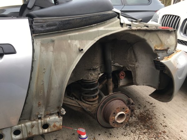

Sp02zbr
Feb 1, 2018
54
I’ve only a 2.2 so not worth spending half that sort of money on.

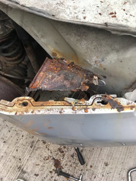

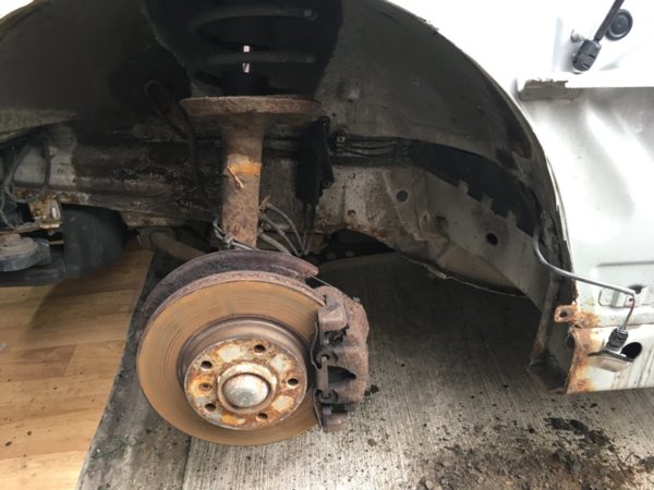

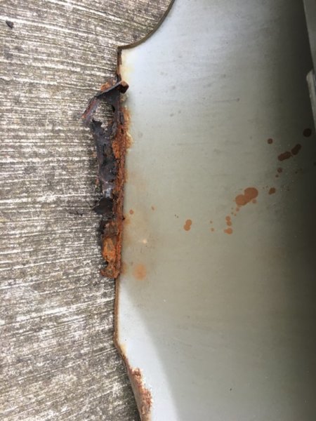

Well that’s rusty
From those pictures alone I don’t think there’s too much different about your car to many. The rear wings commonly rust like that, the suspension looks original and needs changing but nothing new there and the inner sills look solid. I know you have a lot of problems elsewhere and it’s not just that.
Swapping panels is one of the easy bits. It’s cleaning up and repainting underneath which is time consuming. I think me and my lad manage to fit all external panels excl. bonnet and doors in 2 hours. I spent days beforehand cleaning up underneath though.
It seems very similar to how my Titan Silver 2.2 started. That had a dead engine too!
