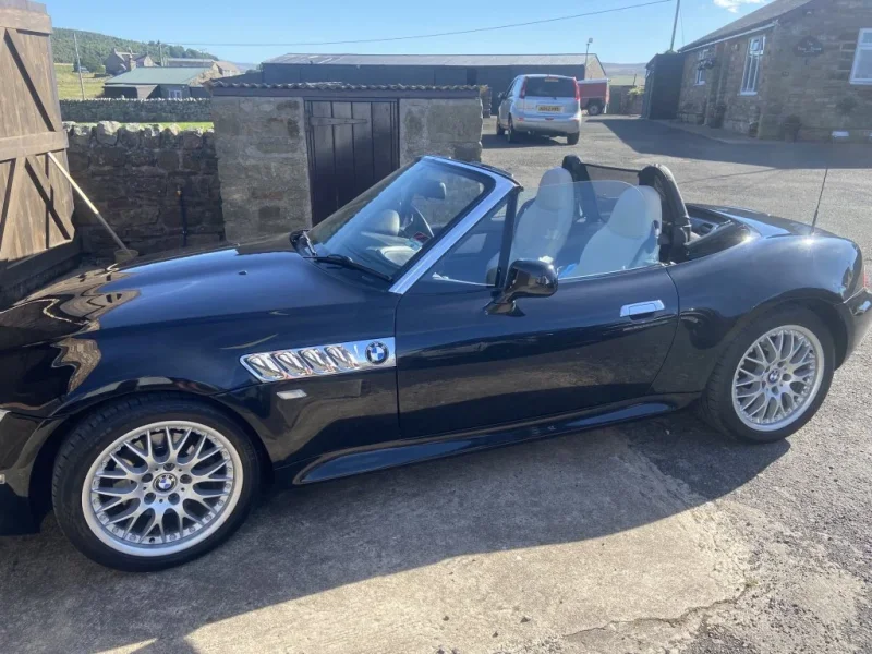

can anyone please tell me how to disconnect the horn on my 2002 BMWZ3 3.0L
When I switch the ignition on the horn is continually on ! Cheers, Paul2E485EB9-E1DC-4AA3-9DEC-5522B31F0D3C.jpeg
