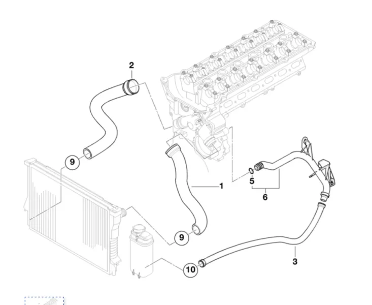

Below is the parts I am planning to fit to my car as preventative maintenance
Meyle Water Pump
Continental Aux Belt
Mahle Thermostat
Mahle Viscous Fan Coupling
2x Gates Radiator hoses (top and bottom) (1 and 2 in image)
1x BMW hose (3 in image)
Is there anything else I should add to this list?
Thanks Chris

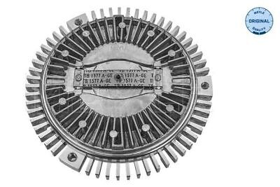

Give the viscous fan drive some serious consideration Chris. They are expensive, but, if it fails it can make the cooling fan blades shatter and shred the radiator.

@t-tony
I have found a Mahle one for £81 on Autodoc
Is that alright?

Is an £81 mahle viscous fan couple ok?
I would be happy to fit a Mahle coupling Chris.. I'll go dig that belt out and let you know..

Viscous couplings - febi ones seem to work best. They're rebranded Behr ones iirc.
