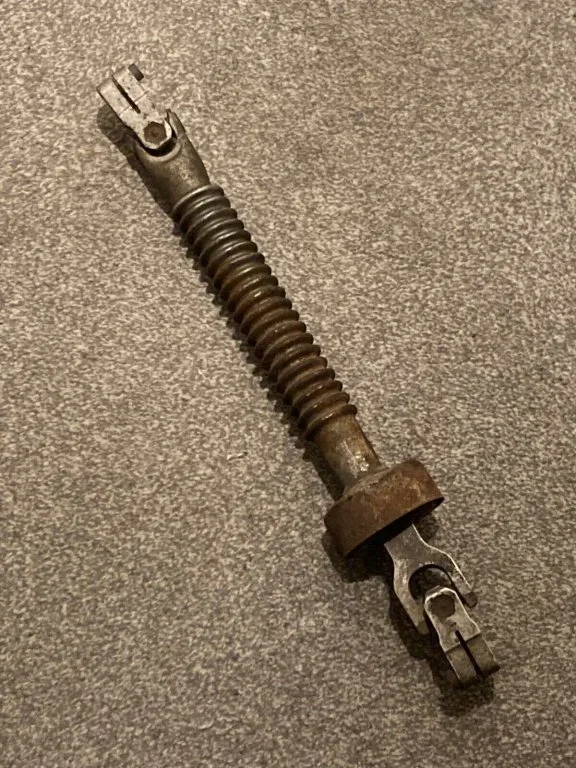

If the fluid level is ok, you’re correct, worth jacking the front up and cycling the steering. If it’s still stiff it’s the UJ’s in the column. If you’re lucky you may loosen them off with oil. If not it’s a replacement, plenty available s/h but do make sure the UJ’s move freely.
If it is seized, getting the old one off is best done by taking the bolts out the rack so you can move it. The replacement should then slide on easily.

Could be the lower column UJ under the bonnet.WD40 and exercise can improve things - you’ll see rust escaping if it’s bad.
Thanks for that, I'll give them a lube up as soon as I can 👍

You have two to lubricate:
