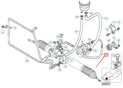

Can anybody help me work what is meant by ‘high pressure’ side/pipe work.
From real OEM it seems it is part number 32416754173
(Item 3 on the pic).
Is there anything else needed when swapping this out?

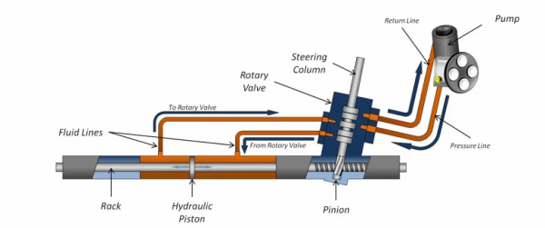

The power steering pump is normally a vane pump with a high pressure relief valve. Full flow passes to the rack and returns to the pump in a loop.
When you turn the wheel and need steering assistance the valves in the rack will start to direct flow to whatever side of the piston needs it. This increases pressure until you reach the relief valve limit. You can hear this when you turn against full lock.
Very simple system but the valve in the rack is very clever.

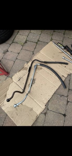

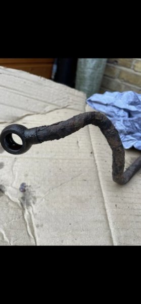

if you haven’t done so recently, you might want to check your steering pipes as you can see from the pictures of mine, the ones that didn’t blow at Thruxton were clearly on their last legs. They get the full force of all the grit stones and stuff thrown up from the road.
