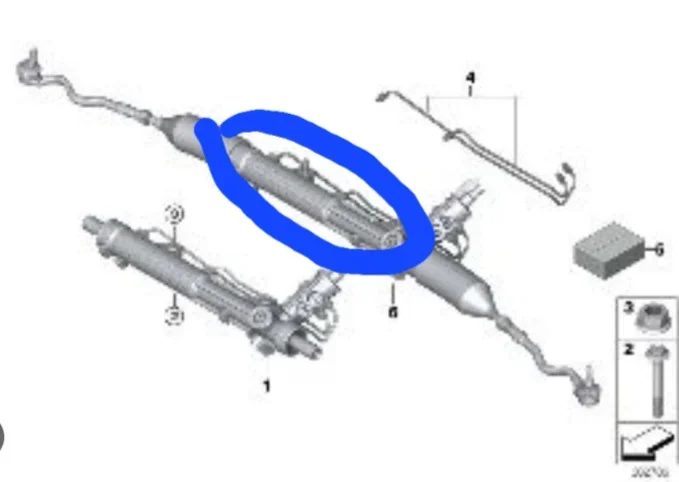

Hi Andy, he only does the return pipe I'm afraid. There's 2 small pipes affixed to the power steering unit itself that have failed. I bought the excellent condition 1.9 rack thinking I could just take them off and put them in the 2.8 but the fitments are different.
I'll try to find a diagram.

It’s the 1.9 gear linkage that’s the ‘quick’ one. All Z3 steering racks are the same..but they are a desirable upgrade to non Z BMWs as they are the quickest (fewest turns lock to lock).means the prices are always quite high

The part number on the 1.9 and 2.8 refers to something different. That’s the part number for the M PS pipes only
