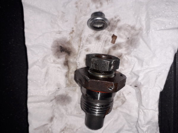

Spot on end of pipe sheared off.
That's good, an easy fix Paul. You can replace it with rubber hose and "Jubilee" clips as it's on the low pressure side. Although IIRC someone on here was looking into getting some stainless steel ones produced which would be the better option.

not sure how its the very end bit shaped like a mushroom

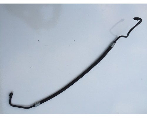

It looks like the high pressure hose between the pump and the steering rack?
If so I believe it's 32416754173 and is £200.
I don't think you'll find that as a 3rd party part. I've looked before and concluded not and started investigating having them made. I'd say the options are:
  1. Take a deep breath and part with £200 for a BMW part
  2. Ask your local hydraulic hose company (likes of Pirtek) to make you one
  3. They are the same as a 2.2 and I may well have a secondhand one if you want to PM me.
