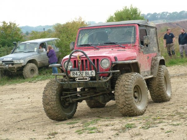

I used to off road a lot and had big Jeeps that had very hard life being smashed on rocks and covered with mud.
Powder coating looked very nice when new but didn't last long. As you said once chipped it would starts to corrode underneath and flacked off in sheets. Items that were painted lasted longer as the damaged was more centralized.

I had a 61 2A for fifteen years. It spent 10 years as my daily driver. My last Jeep followed me from the West Coast of the States down to the Islands then to the UK. Used it for awhile but it became less and less so it moved on for the Z3.
I owned the Jeep from new and the first few years all the and parts were powder coated. Even living in the mountains of Washington State and Oregon where rust isn't an issue it was all flaking off because of the damage. After that it had normal paint applied for the rest of the 20 years I owned it. I didn't have near as much trouble and could just touch up spots as required. I built the front bumper above and it wasn't just for show. It took a good amount of abuse through the year. In the winter I could touch it up or repair it myself unlike powder coating.
