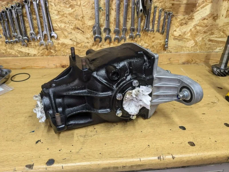

I am finally getting around to doing permeant repairs to mine after limping it along for several years of abuse. I have a pile of metal and cutting discs at the ready. Plus I am fitting a twin eared diff cover.
