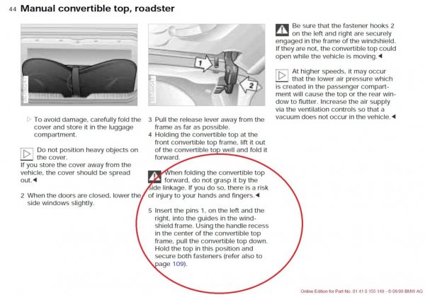

BMW wouldn't have sold hard tops if that was the case. Mine is on for months at a time, I've never had this problem.
Pull the top down to the windscreen fully before using the clamps.
Edit: There is of course the other option, RTFM. It works, who'da thunk that eh? ;)
