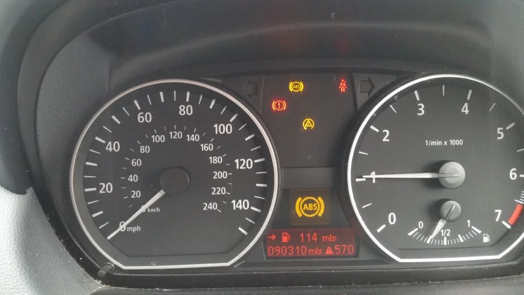

My 7 mile commute to and from work is a complete farm track :wideyed:
Hit one, in the 120i, i could not avoid due to double parked cars and the ABS and asc lights came on.
The car started to judder, initially i thought i was running out of fuel.
Hoping it's just a dislodged ABS sensor. Could it be worse?

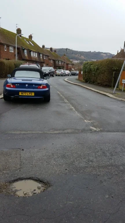

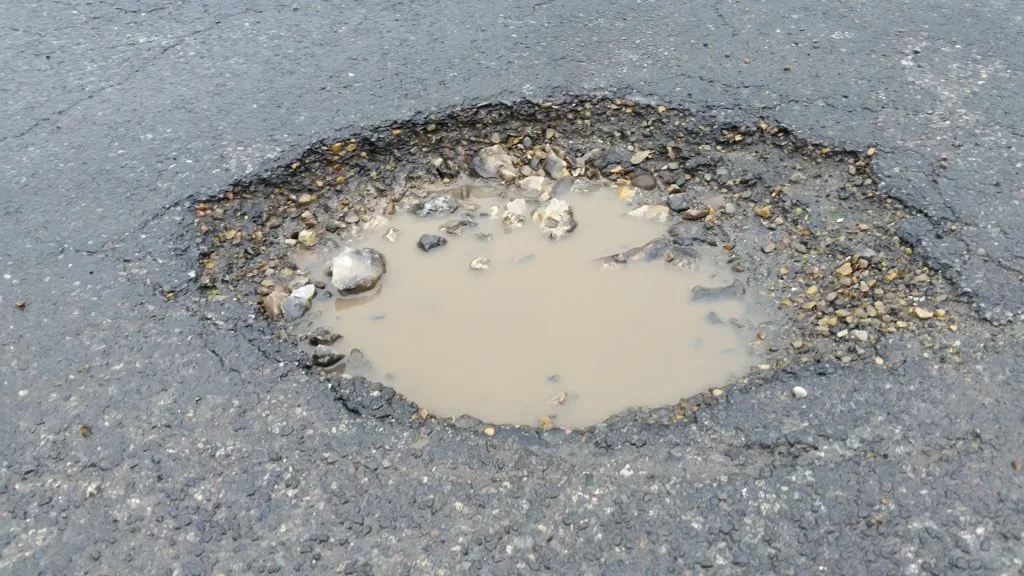

This one is just outside the house.

The impact could have dislodged the ABS sensor (if it wasn’t fully secured in place) - I had the before - chasing ABS light fault - bl@@dy sensor was on and looked in place but was not properly ‘clicked’ in place!
No idea why it shuddered though. Could be the DSC going nuts and cutting the fuel like it does to stop a slide.
