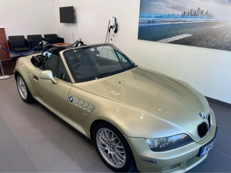

I am looking at this car as a possible purchase. There is no accident history but mild rust around jacking points. Registration number RV51YYN but the car is down as green! Opinions, please!

Just had a look at its MOT history here https://www.check-mot.service.gov.uk/results?registration=RV51YYN&checkRecalls=true
Last MOT lists the jacking point corrosion. Previous couple of MOT's did have advisories since they are not present on the latest test just check if they were dealt with. Shock absorbers, brake pipes and suspension pins or bushes should all be checked.
To deal with the rusty jacking points best to take the outer sills off to see what the inner sills are like and the rear of the cover sills. With the outer sills off and the plastic jacking points removed its easy to treat corrosion. Check for any warning lights on the dash and ensure the airbag light is lit when ignition is first turned on and extinguished when the engine is started. It is not unknown for dash warning lights to have bulbs removed or blanked out to mask the problem that has lit them.

It’s Pistachio (nice!)..so green is technically correct

Rear window looks like its had a replacement, the seal around it isn't factory and doesn't look great. Roof replacement at Jack Smiths in Swansea around £350 would put that right, its the place to go for a new roof.

Roof needs replacing as the tape around the rear window is a sign of rotten stitching, With rusty sills I would value it around £1500 providing it is a 3,0.
There are lots of Z3s around at much more sensible prices, if the sills are rotten it will turn into a money pit.

The outer sills are only covers and not part of the structural integrity of the car as has already been mentioned.
Although Althulus has pointed out an extreme case of inner sill corrosion, in all the years of owning Z3MCs since 2005 I’ve only been aware of two cases of inner sills requiring repair, one on Z Coupe Forum and if I recall one car on this Forum. Other than that everyone who has carried out refurbishment of inner sills seems to have done it along the lines of how I did mine.
Looking at the car you have in mind (bearing in mind we are looking at photos) it generally looks in good condition.
What is required are either close up photos of corrosion around jacking points or a physical inspection of the car to see if it’s just corroded sill covers. Without removing outer covers you cannot see the condition of inner sills.
Hope this helps. :thumbsup:
