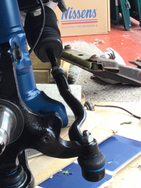

The inner joints are called axial joints, they are hidden inside the rack gaiters so you can’t actually see the ball end in question, it’s quite an easy fix, however what I would recommend is that if you do change the inner/axial joints also change the outer tie rod ends and also the rack boots, you will then need to get the tracking done on the front once fitted.
If/when removing the existing rod and ends, cut the rack boot off and measure the length of the tie rod assembly as best you can whilst they are still connected together on both sides, these measurements should then be used when fitting the new tie rod end to the axial joint this will make sure the new parts are as close to the original length as possible prior to getting the tracking done.
if you want advice re sourcing the parts, I can help.
i have attached a picture of the tie rod assembly for reference.
Also if the boots are worth keeping I would just remove the big clip and slide the boot off so you can see the 30mm (I think) hex. which you use to unscrew the link off the end of the rack. Wind the rack into the housing so that you can still just get the spanner on the hex. that way there's least strain on the rack itself when you unscrew the joint.

Just by way of update, had inner rack joints and track rod ends replaced today (thanks for latter suggestion @Dakar Z3 ). Rack boots (although seemingly original) were fine. Mechanics experience is that originals, if not damaged, are better than replacements which are, in his opinion, of lesser quality. Tracking done of course.
Despite no discernible play before (by me), the steering is super sharp now with no understeer at all; good old 1.9 rack! There must have been play that I hadn't noticed.
I now think that the original "play in lower steering column" comment was a red herring. Hopefully so as part is said to be NLA.
Good outcome in the end. :)
