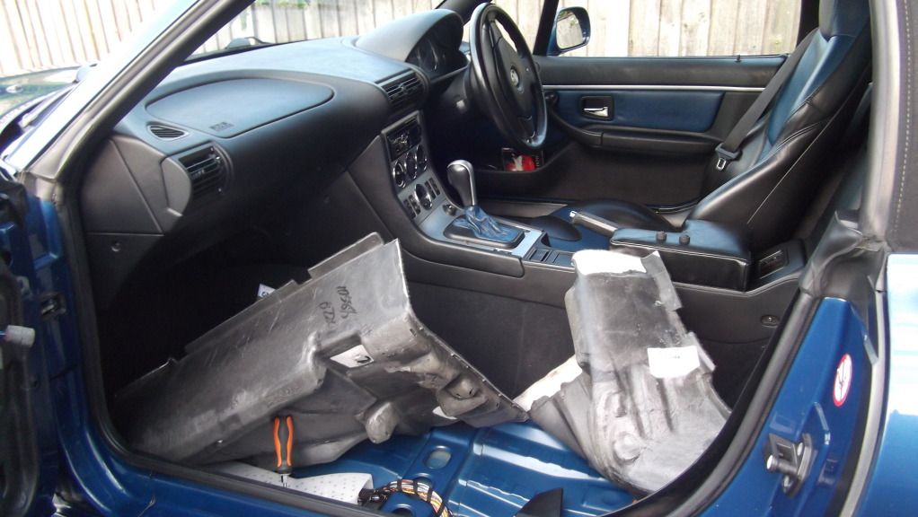

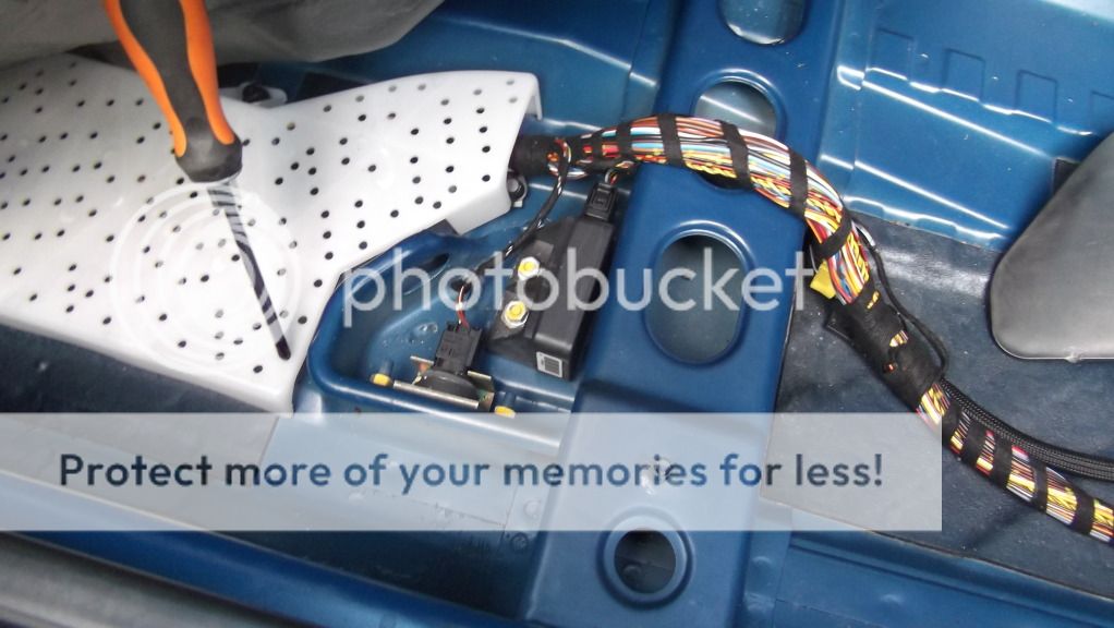

Whilst waiting for the helpful man with the code reader I decided to try and find the sensors which according to the schematics I found are under the drivers seat, but after taking out the drivers seat I found nothing and then realised they are all written in american so found the sensors under the passenger seat. In the process found the carpets wet and the foam backing soaking but nothing around the sensors but will wait and see.

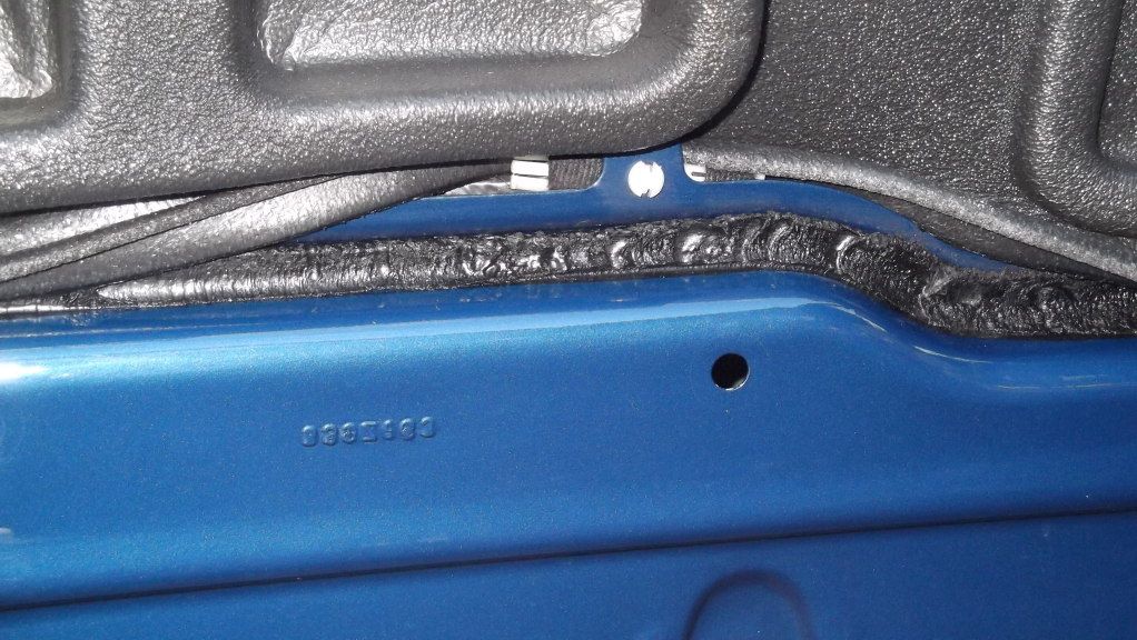

Started to trace the leak and I think I've found it with, Sheila's help, the inner membrane of the passenger door was not glued down so the rain/washing car water ran between the glass and seal and found it's way past the membrane and into the car. There was quite a drip when I sprayed the hose on the window. So dried out and stuck down with silicone.
The offending sensors I hope
Looking sorry for himself
The missing sealant on the door
