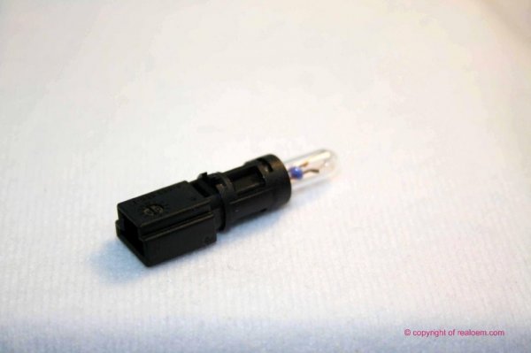

I have noticed I have a bulb out on the heater controls what kind of bulb are they and how do I get to it?

I think the bulb is BMW only its small and stupidly expensive.You may get an ram second hand but most are sold complete with the pump and pipes etc but you may get lucky.

Just changed the same bulb on another members car, only get replacement from BMW and its about £10 per bulb. Its a fiddle to get to it as well, pull the heater knobs off, radio pulled out and loosen a couple of screws either side of the radio gap, unclip the top of the heater dials and push it back whilst lifting it from its bottom locating slots. Now the fun bit working through the radio gap turn the unit over to see the back, locate the bulb and pull it out, its a tight fit and needs some force. Once out pull the bulb from the holder and pop new one in. Just check it lights before you put it back in reverse order. You might consider replacing the other one at the same time so you don't have to go through this all again when that one fails.
Suggest you ring Sopers BMW at Lincoln to order the bulb(s) ask for zroadster forum discount. they will post them to you.
Part number 61138353797

Perfect thanks for the info
