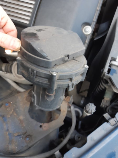

Anyone know what this part is/does. Left front of engine.come off its mounts, but ok as sits in a holder. Rubber pipe has perished though I've noticed

That's an air pump, it runs on start up and adds air to the gases in the exhaust system to promote a complete burn.
You probably wont pass one of those inspections if it has a bad hose.
@Braz86 these were only fitted for the US market. Removing it will make no difference to the MOT Emissions test here in the UK. All you need to do is remove it and bin it. Block the vacuum pipe and tie up the electrical connector and fit a blanking plate on the cylinder head. Job done.

I am planning to do the removal with T- Tony's blanking plate - will try get some pics if anyone is interested. Ta
