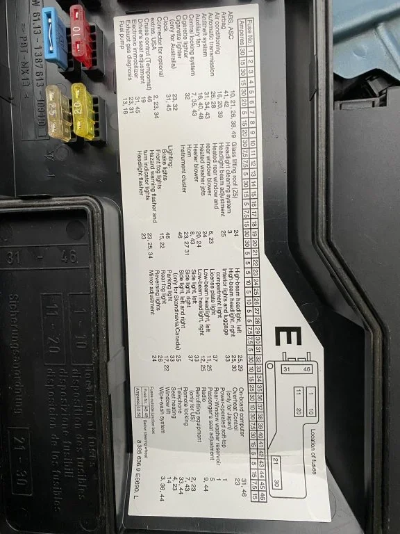

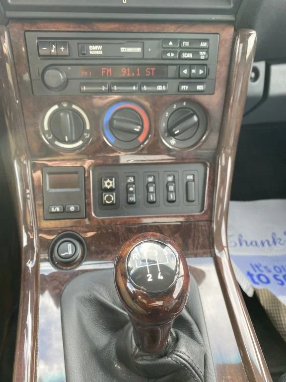

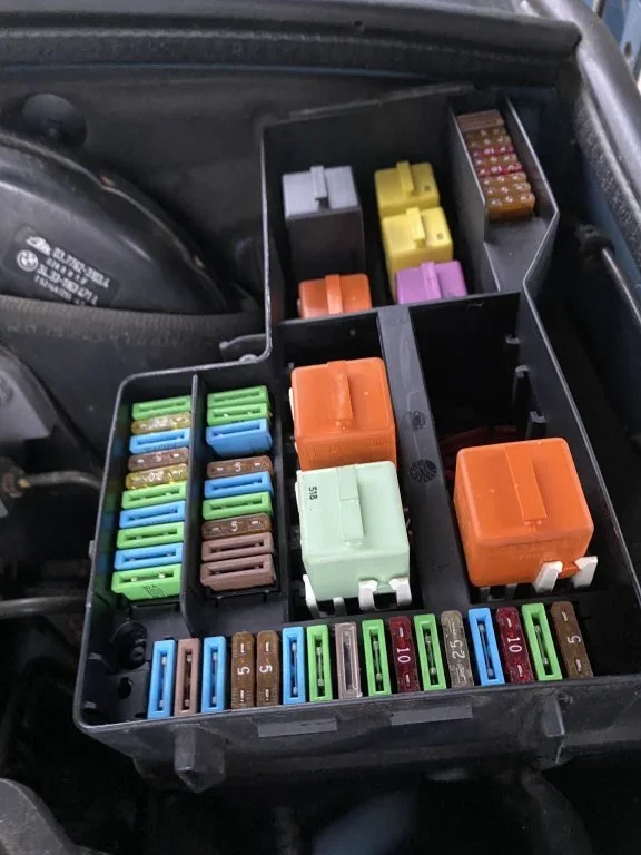

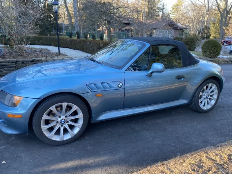

Greetings All
I am the new owner of a very clean 1999 Z3 2.8 with 67,000 km bought from a friend who has owned it from new.
Two very minor issues which appear to be power related however in both cases the fuses appear to be fine.
1. On Board Computer is blank. The previous owner recalls it to be operational.
2. The side view mirrors to not appear to work via the switch in the drivers door.
I have recently had some work done on the car to certify it to local standards and address issues related to lack of use, brakes, calipers, rotors, coils, plugs etc. Some sensors and bushings.
Aside from fuses is there anything else I should be checking as the root of the problem. A common cause?
Help and insight welcome.

Hi 1998 2.8 computer died when it was laid up for 12 month the display would only show four lines down the middle i had to replace it with a second hand one

Remove the computer and unplug it from rear allow 24 hours to mother warm and plug it back on it should resert
