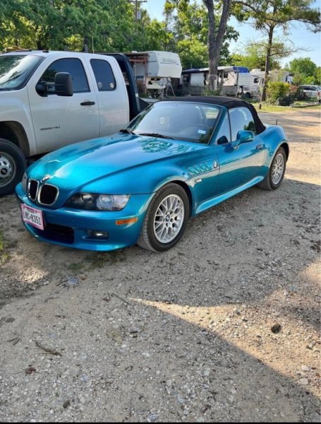

I previously owned an M Roadster and so was knowledgeable about subframe reinforcement. I'm looking at a 2001 2.5i model in Atlantis Blue ..
my favorite BMW color. When I pulled up the carpet to look at the welds, I saw the attached picture. There is a plate over the welds which did not immediately give me a clue as to how to remove. I was wondering if it is a reinforcement of some type? Did the Z3 come with this plate already attached in 2001? Any advice appreciated.

That’s a fantastic colour. Never seen one in the flesh.
