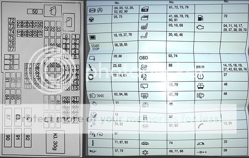

As @Jack Ratt says the hard wiring kit comes with a piggback fuse so if you can get access to the fuse box remove a ignition fed fuse and plug the piggy back into the fuse location and the put the original fuse back in the top.
looks as if this is fuse diag for E89 and fuses 6-10 are ignition fed.
