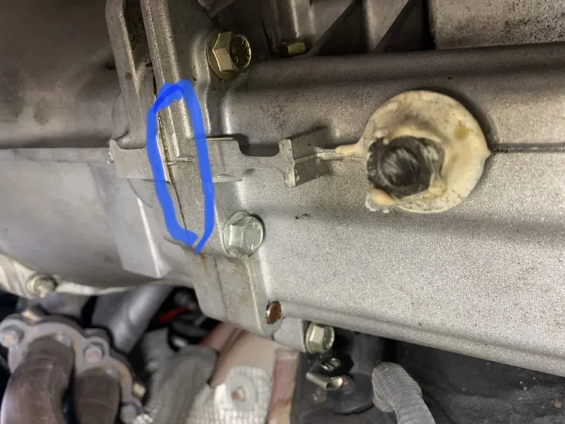

Dear friends,
I found the old leak from the gearbox. See the attached. Can you advise me how yo fix this ?
Regards
colb
Nov 25, 2012
178
Newport, South Wales,UK
Looks like its a gearbox out job to find the source of the leak, most probably the output shaft oil seal leaking and finding its way to the joint you circled.
