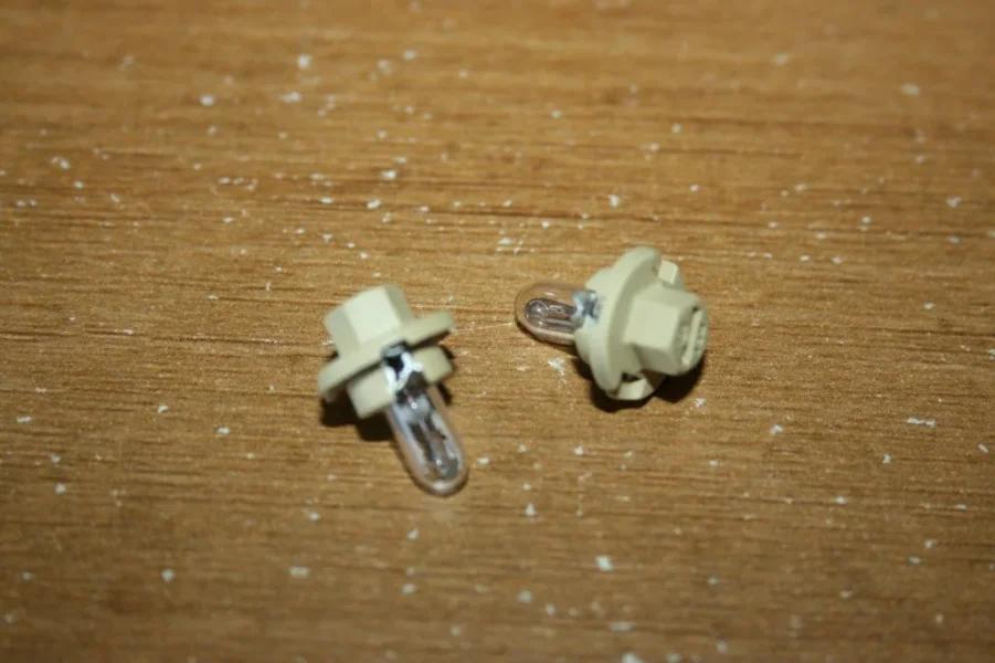

There are two 1.5 watt bulbs for the display. They are beige, all the other bulbs are black (1.2w).
It may be an idea to check all the other bulbs aswell while the cluster is removed (cos it's a pain to do).
I have two working bulbs you can have for postage, as well as some spare black bulbs for the other lights, if you want them.

So thanks to the help of Pond I have swapped out the bulbs and can now cleaerly read the mileage of 67,000 miles!
Popping out the instrument cluster was straight forward enough following the instructions on here and I did no teven need to disconnect the wires as I could easily reach the bulbs.
