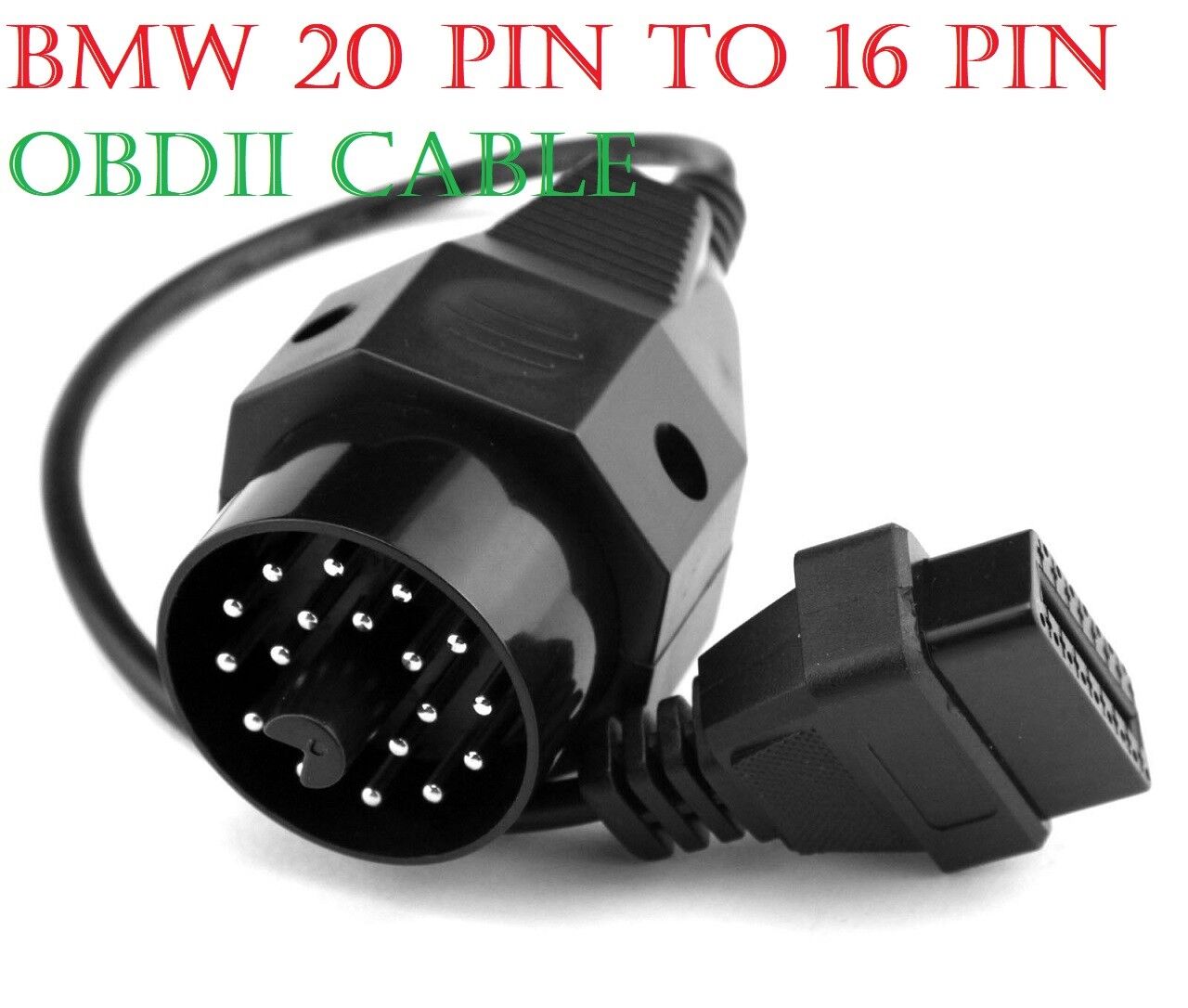

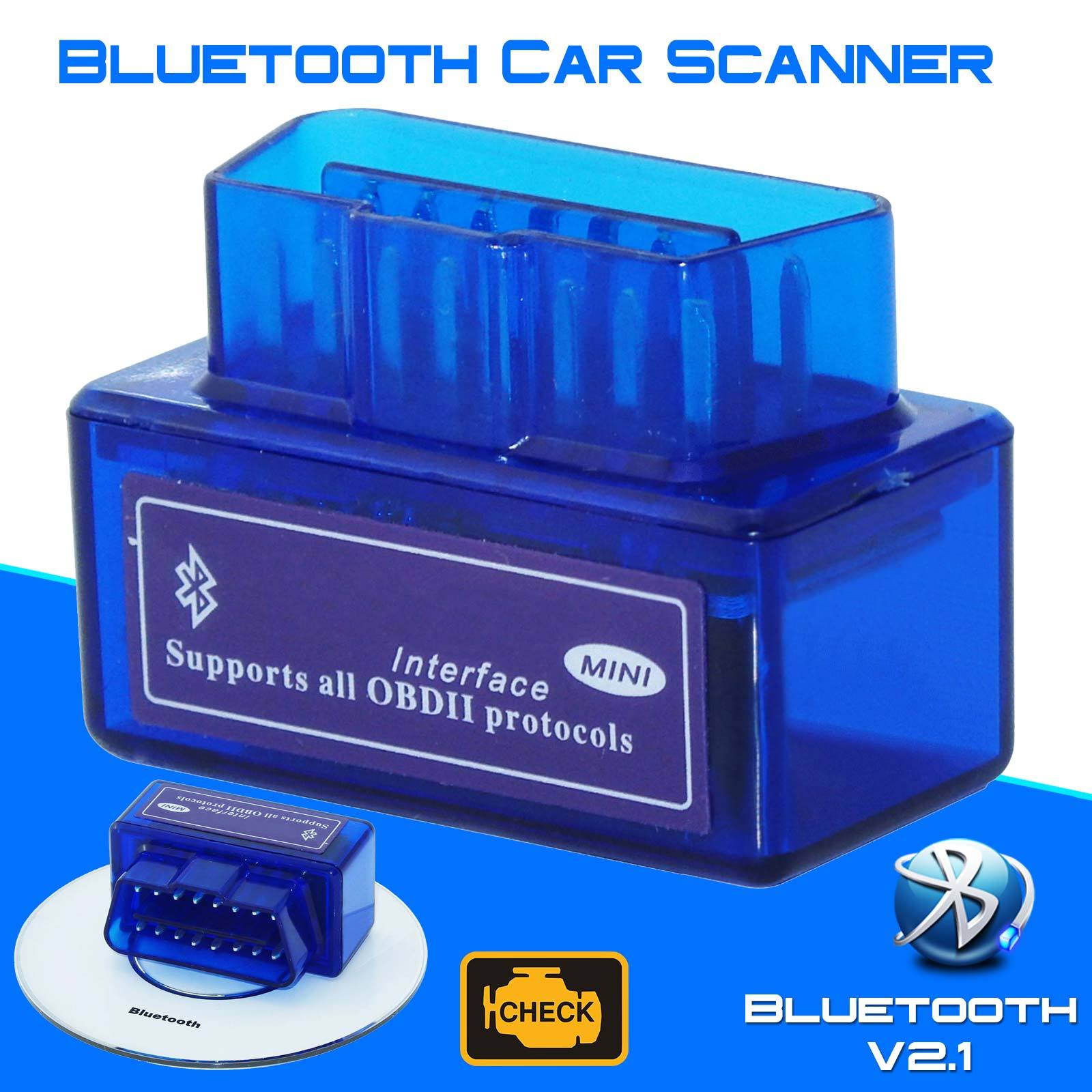

I just use a bluetooth obd reader with the 20 pin conversion cable and Torque android app its all you really need as it will read fault codes and give you live data in the car when you driving,, its real good and well worth it.. cost about £15 for the obd adaptor and the cable

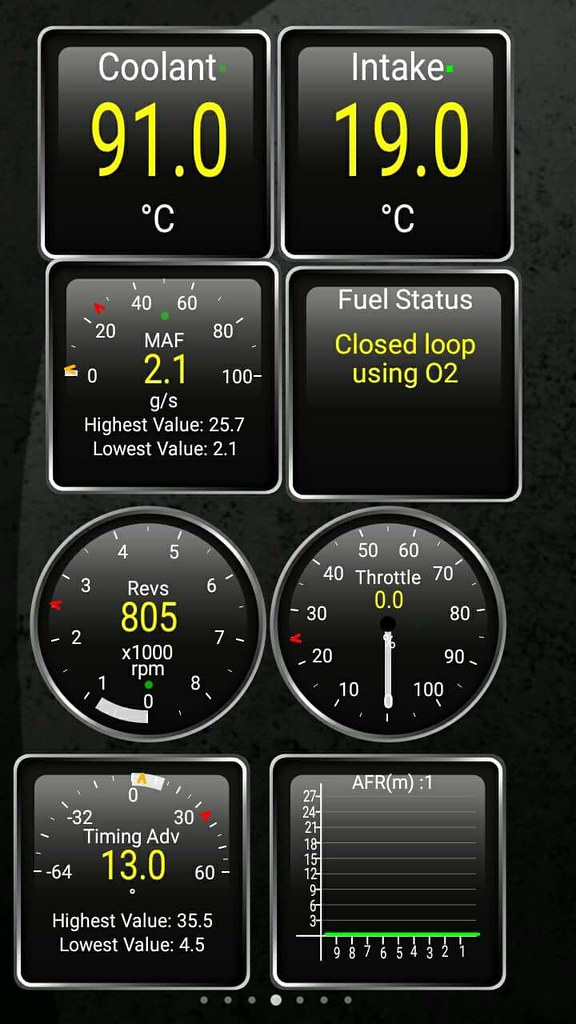

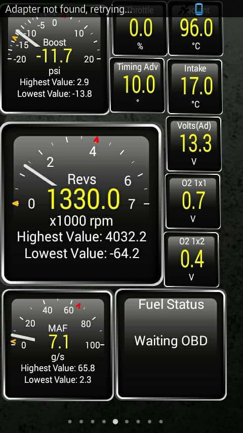

its really easy if you can use a mobile phone you can use the torque app download the app and have a look at what it can do.. you be amazed... you can reset the fault codes, run live data monitor sensors to see what they are doing..

works fine on my 1.9 m44 but you need the 20 pin convertor cable i listed earlier but you will need that cable even if you get a normal coder reader
I not tried it on my 2.8 yet as its not on the road yet in hindsight i should really get it hooked up and see if all is well with the 2.8. maybe i will in a few days time... the fella i had the car off gave me another 20 pin convertor cable and an inpa style adaptor

Thanks for info I have just ordered Blue tooth scanner.
I already have converter cable, INPA on laptop and have used OBD doctor basic via ELM to MacBook but this looks less cumbersome. Where have you mounted unit? There was a long discussion on a thread a few years ago now and I recall one of the problems was with the unit working loose during driving.

My Bluetooth unit is just cable tied loosely in the area where the master cylinder is...I get great Bluetooth signal to my mobile phone from there the only modification you will have to make is either take the top off the 20 pin adaptor cable or move the 20 pin adaptor socket a bit lower down to enable the bonnet to close...
