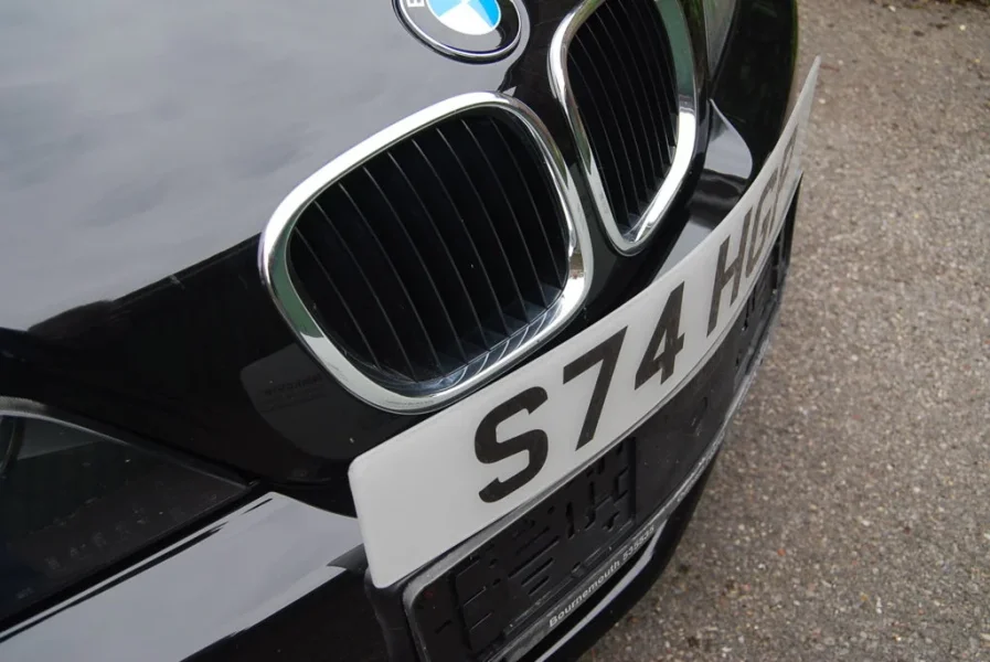

    Have read on a couple off forums that some Zedders have problems with number plates becoming loose

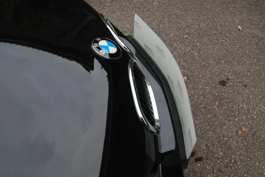

    from the double side sticky tap. could not see what the problem was until I moved Zelda out of the garage:eek: and then I saw it number plate ends started to detach from the backing:rolleyes:, so decided to take plate of and re-fix but then it struck me:nailbiting: the plate material is plastic so it needs a bit of moulding for the backing plate see photo's as to how I fixed it.

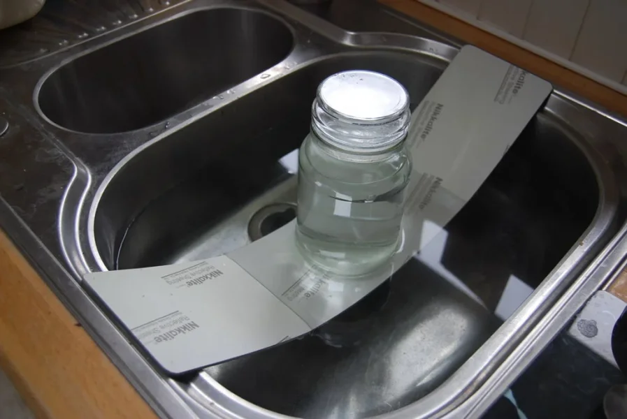

    1st fill sink with hot water and suspend plate with weight this will mould plate to wanted shape being plastic it will retain this shape it took me about 10 min's

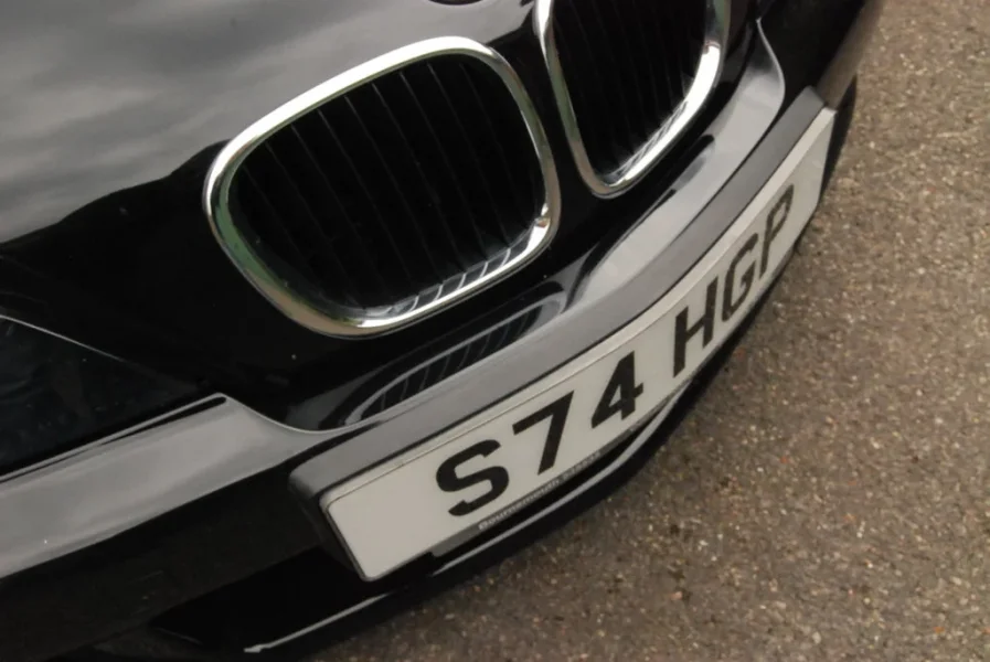

    2nd keep checking for desired shape when obtained dry and then fix with the usual double sided tap;)
