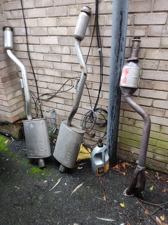

Both exhausts have small cracks in welds . Cat is a fine just didn't help me meet emmisions.
