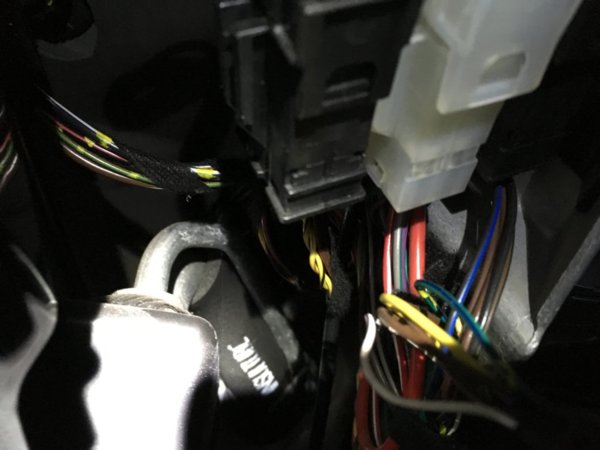

,Success
I took the covers from the steering column off to discover one of the connecting blocks was loose and not clicked in,god knows how that happened.
Only issue now is the temp and fuel gauge don’t work.
That some good news mate.

yes it is, very pleased to say the least plus the wife said it was a loose connection! perhaps i should let her work on the cars !!i hate it when sh is right :whistle::whistle::whistle::whistle:
thanks for the help everyone
Guess that's the bad news then Dave.=)) @Sean d has had issues when his "clocks" have stopped for no apparent reason maybe he can show some light?
