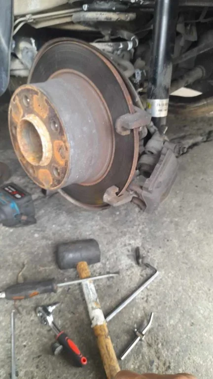

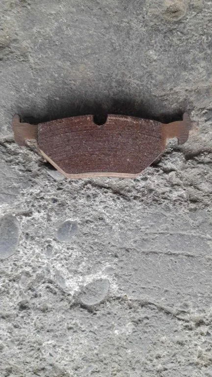

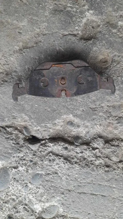

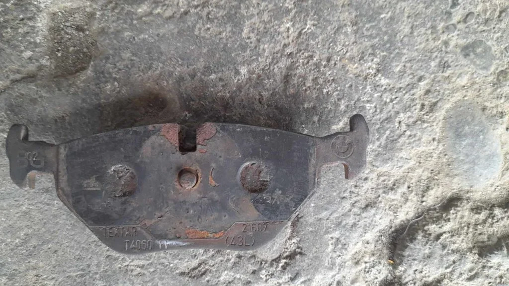

its already 2 months i have noise under the car,,,i change muffler , change all bousing ,,,remove break cover from shocks ,put back the hand break cabel back to is clips ,,,,,tied the heat shield,,,noting solve the problem,,until i saw in you tube a guy punch the wheel with rubber hummer , to find the noise,,so i find it,,in the rear driver side ,,the 2 pad where loose ,,,,the mechanic add me iron metal in both side ,,and no more noise,,lucky i live in philippines,,,cost me 5$ us,,, it took 1 hr, cause the mechanic did not have 7 elan to open the break, only 6 and 8 ,,,so i had to go my house to bring 7 elan ,,,,
