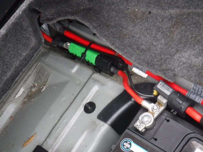

Hello all,
I have a 1996 bmw z3 automatic which will not start in warm weather. It will not even crank. When the weather dips below freezing, the car will generally start.
when I put the key in and try to start I hear a click. The overhead light will not come on, and the windows will not work. But the dash lights up and the radio works.
Some things I have done:
1. replaced battery with a new battery.
2. Checked and replaced all blown fuses.
3. Found an article about the EWS might be faulty. So I followed a troubleshooting article that had me short two pins on the EWS. At this point the car would crank but not start. (The short has been removed)
4. if I put the key in, then turn it as if I am starting the car, I can reach into the engine compartment with a screwdriver and crossover the engine to the starter and the car will start. However, even running, the windows will not work. When it turn the car off, it will not restart on its own.
