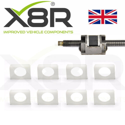

I recently purchased a bright red Z3. June of this year. The car came with one or two issues, one being the problematic sliding drivers seat when braking etc. I have read about replacement bushes. Where can I purchase these from?

I've got the same problem with mine. My new bushes have just arrived this morning, and I plan to tackle this job tomorrow.
My airbag light is also on, so that's two reasons to take the seats out, and look at the seat wiring while I'm at it.
I did find a couple of good videos on Youtube with instructions also, so worth checking out if you prefer a video tutorial!
BMW Z3 Z3M Seat Rail Bushing Bushes Kit White Spacers Set of 8 52107137499 | eBay
I'll let you know how it goes!

Hi and welcome. I have a new set of seat bushes £8 posted. If interested pm me.
