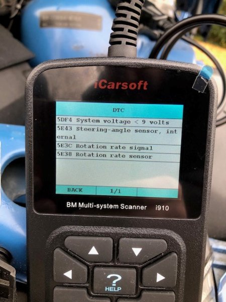

Update - Finally got the cable and have plugged it in this morning and there's a ton of codes, I've photographed the screen to show them, looks like the yaw sensor(s) are to blame, I'll have to check them out. Do you have to take out the passenger seat or can you access them with the seat in place? Thanks

Definitely need to take the seat out and very likely you have a swimming pool on the floor pan, won't make sense to change the sensors if you don't figure out where the water comes from first and fix the leak.

Yes the seat has to come out, and the other problem is that the carpet (which has the thick foam bonded to its underside) is one piece going from one sill across the tunnel and right over to the other sill. So without dismantling the entire centre console and heater, it won't come out. I ended up removing the rear part of the console where the gear lever and handbrake reside, and then cutting the carpet down the length of the tunnel so I could remove the left side completely. Once the console is put back you can't see the cut at all.
Since then I have cut a flap in the carpet which can be lifted up to expose the two sensors. But first, you must stop the rain getting in!
