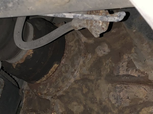

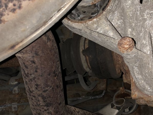

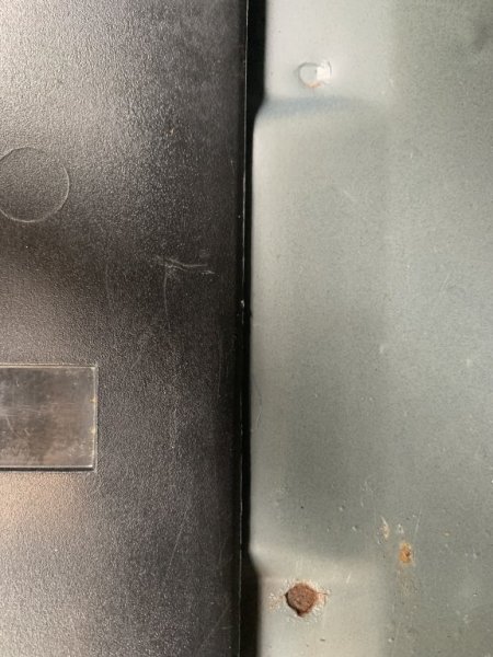

Hi there,
Looking for advice and probably a rough cost on repair.
I bought a z3 2.8 at the weekend.
On closer inspection I’ve noticed one possibly two of the spot welds in the boot starting to pop.
Has anyone had this repair done and if so what kind of cost are looking at?
It’s going into on Thursday for further assessment.
Any opinions greatly received.
I’ve posted a few other pics of work needed done too
Regards
Gareth

If they are just cracked and not pulled get them drilled out and welded back up.. Also looking at the diff bush it looks fairly knackered, I would change it ASAP as that wont help with the welds and was most likely adding to the cause if the diff was sloping around in the carrier.
Great thanks.
That sounds like the cheaper option at the minute I’m pretty sure one has definitely popped with one possibly about to go.
I’ve ordered a new bush yesterday for the diff.
Do you think the driveshaft flex disc would add to the noise too?

If you drill the spot welds off from the top using a proper spot weld drill bit it should just remove the top "layer" of metal leaving the bottom layer already cleaned up ready for welding. If you can drill the welds off it should be a simple job to re weld them. You do have to drill accurately in the centre of the spot weld.
These drills vary a lot in price.

Is this essential at this stage?
Mine is almost identical and has been for a number of years - not getting any worse ( 2 indented with slight rust - before I cleaned).
I remember being worried about it initially and comparing it to others on one of the Scottish runs and about 4 cars had the same.
Redsheep
May 2, 2016
108
Aberdeen
2.8
Just went out to check - yes almost identical

Welcome Gareth. I’ve just done a spot weld repair on a Zed. Drilled out the 6 spot welds to expose bare metal and plug welded them. Tidied it all up with a flappy wheel and sealed it in.
