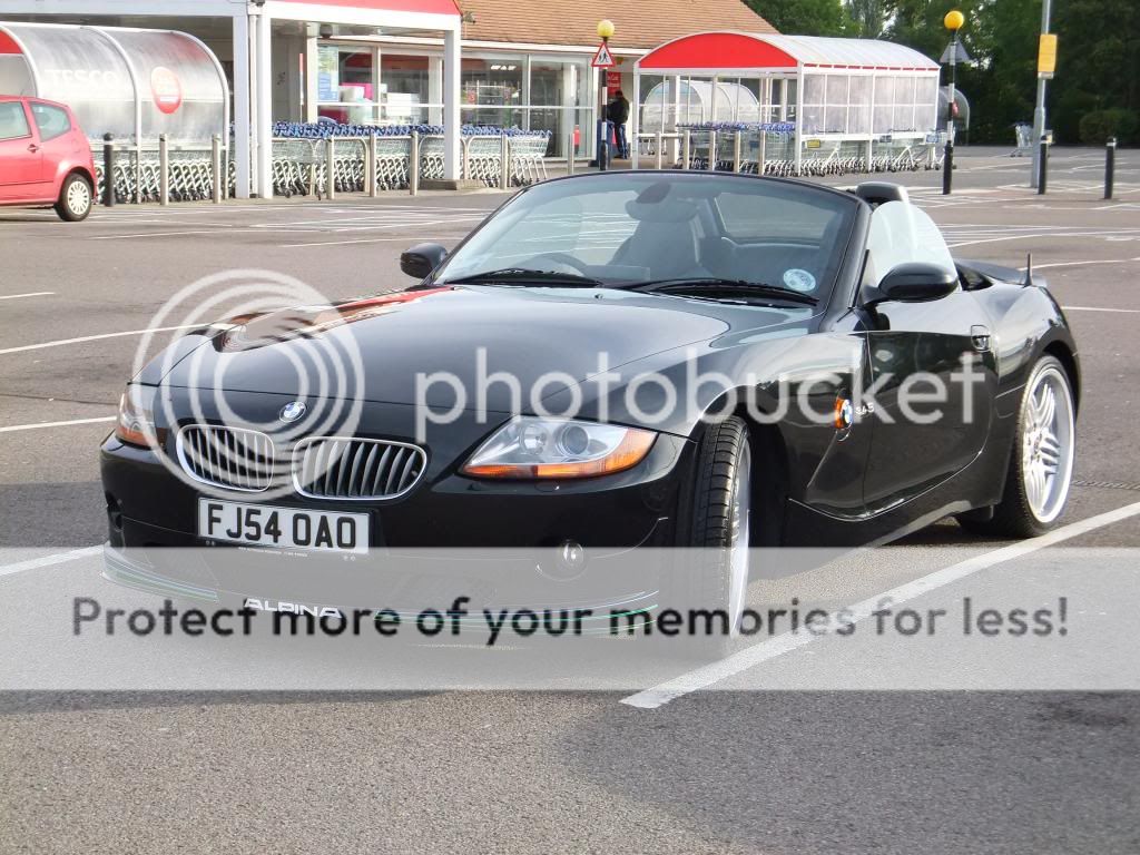

I started my late life crises about four years ago and then went out and bought my first roadster a Z3 individual and loved it, then because it took over my
life, i changed it for the Alpina. Whats good about these cars is the friends you make and meeting up at events that are organised frequently over the summer months,
got to know so many people since owning one of these.
