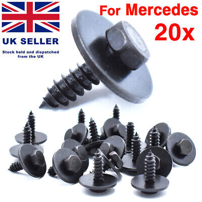

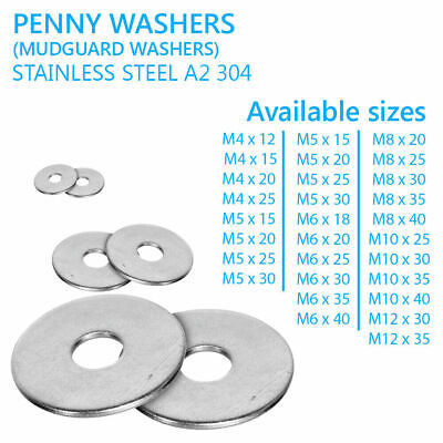

I have used stainless steel screws around the wheel arch liners on my Z4 sourced them on ebay also used stainless washers to increase the flange size of the bolt heads also from ebay.
When I removed the cover sills on my Z3 I did replace some with BMW screws obtained fom Sophers at Lincoln using the forum discount, would use the stainless ones if I were to do it again.
Oem shows size of the screws as 4.8 x 16
