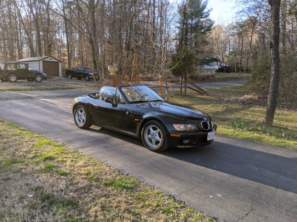

Hi All,
I just bought a 96 Z3 1.9L roadster with 88k miles and I'm in the process of getting it fixed up. It has pretty solid service records, and It runs and drives pretty well, but so far I have the following list:
  1. Replace Stock Radio - likely including speaker and subwoofer replacement
  2. Install new seat bushings kit
  3. Repair door pull handles
  4. Change all fluids, inspect suspension, etc.
I have founds some good resources here for most of the above, butI also noticed that the heat was very intermittent, sometimes blowing very hot and other times blowing room termperature without me adjusting it. I am wondering if this is a common issue that others might have solved.
Advice on this or other key repairs or maintenance items would be greatly appreciated.
Thanks,
Mike

Welcome Mike, no input needed from me they nailed it above. Do we get to see a picture of your zed :D
