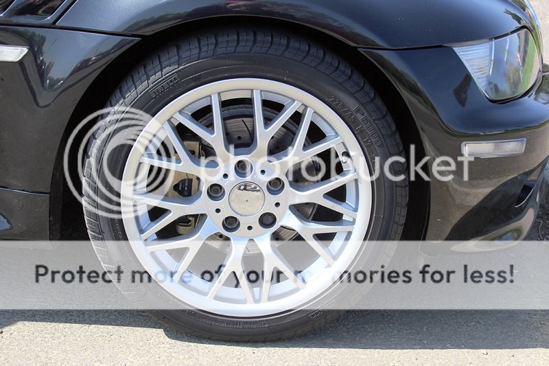

New brake discs on the Z3 looks a bit odd but its just rubbing off the black coating that stops them rusting... hate seeing rusty brakes through nice wheels (also drilled and grooved), the old brakes were so bad I had to use a lump hammer to get the old pads out then used a wire wheel on a drill to remove rust from the calliper and the backing dust plate thingy , then use some silver spray hammerite like stuff and coated the callipers in a heat resistant paint but damn you should have seen the pile of rust left over when I was all done!
They are Mtec disks and mintex pads the same as my Alfa and after 30k they are still like new
