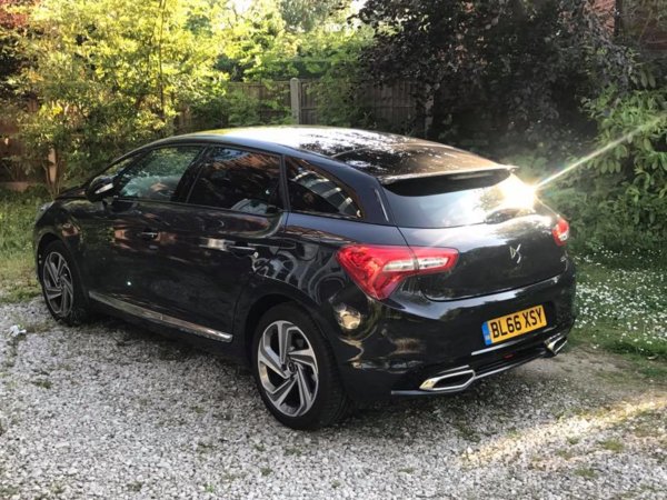

Sure I will like it the thing all feel like a rocke shop compared to my DS
