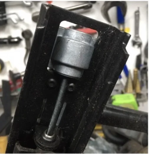

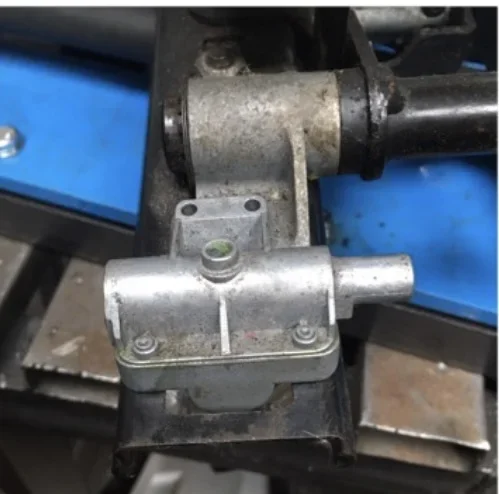

The motor spindles run these little gearboxes,
The gearbox converts the rotational movement through 90 degrees, helpfully (not), it’s bolted on from underneath. One of mine had something jammed in it, so I had to smack it off with a sharp chisel. It’s alloy, so it will come off without distorting the rail, at least mine did.
Removing it shows another little flexi spindle which turns the rail.
The motor spindles are too large. You can’t get a drill in to utilise the little flexi.
I removed it and ground a driver bit to match, it’s square profile, either 3 or 3.5mm, I’ll try and find it tomorrow. Long flexi driver extension, either by hand, or drill, moves the rail directly. I did it by hand, it’s not that bad, and it lets you know when to stop as the effort increases, swap to however you’re operating the other side.
Obviously you need to replace the little begger, I have one spare, a left I think.

Thanks, I will give this a shot. Where exactly did you hit the gearbox with the chisel? In the area I circled?
IainP
Feb 20, 2019
119
1.9
I hit the entry spigot first, I knew there was something jammed in there. I hoped I’d get access to turn the worm gear in some way. Didn’t work it was wrecked.
I then placed the edge of the chisel between the steel frame and the gearbox, just in line with the rivet. Acted like a lever, one good smack and it split at the rear.
I was using a lump hammer, wasn’t going to get much of a swing.
I reckon if you lever it up from the front with a heavy screwdriver the alloy will snap.

Thanks for all the help. I finally got around to fixing this. I used a heavy flat head screwdriver to pop out the seats gear box. I then used an extra long square drive bit to reach the seat gear directly. Worked like a charm
