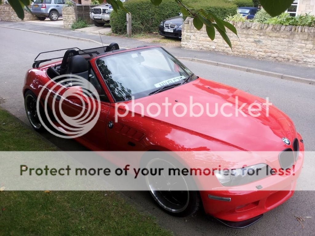

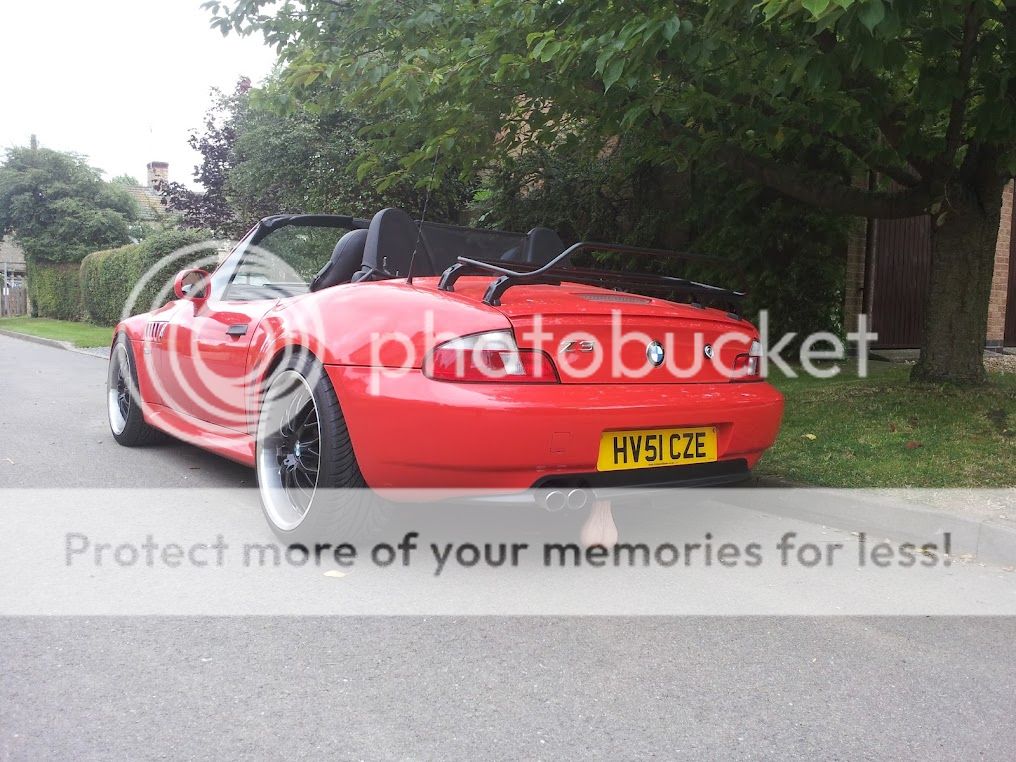

Really happy with the way the car is looking now. Had the coilovers fitted at the weekend, along with Powerflex lower wishbone bushes (Eccentric from the Z3M) and steering rack spacers for more lock Also fitted 6mm spacers on the front and 16mm on the back. Had the alignment done and now have nice amounts of caster up front along with nearly -2 degree of camber and nearly -3 at the rear. As well as looking badass it handles so much better. I've done similar upgrades on many cars in the past and never have I noticed such a difference!

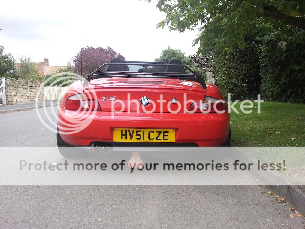

Also fitted by <£15 spoiler off of Ebay 8-} Come ready painted and not cheap crappy fibreglass either, again really happy. I fitted it a lot lower than I've seen others do, mainly because I like to be a little different and also to get more of a 'ducktail' look to it :-?
And lastly, fitted my luggage rack ( This is just a practical thing. I need to transport at least two wheels with me to an event, along with a load of tools, jack etc. So this is me giving an alternative to a tow bar and a trailer a go. See how that works out. Anyway I got it of off....yep Ebay 8-| Was off an MX5, come in chrome so x2 cans of Hammerite satin back later and it fits in with the theme quite well L-) However I really don't think the paint is going to hold up for long so may end up having to get it sandblasted and powder coated - it'll do for now. And in fact I quite like the look of it on there :-^
Then there is the....mmmm.... comedy mod x_x 'These' I will only fit at drift events, no way I'm driving on the road with them fitted, well not through my village with its little old ladies and children ) For those who don't know, its common in the drift scene to hang something from the back of the car, normally a little mascot, cuddy toy that sort of thing. Well wanting to be different I got these from the US. I run them on my competition drift car all last season, got a lot of attention which always pleases the sponsors B-)
Right some pictures:
